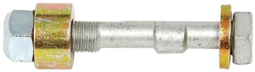

Originally Posted by solidONE View Post
The h&r bolts got me a plus/minus .5 degree of adjustment.
What is it about the h&r bolts that's different then other bolts?
Old 03-14-2015, 12:11 AM   #2359
solidONE
solidONE's Avatar
Drives: FR-S Whiteout
Posts: 2,863
Thanks: 1,808
Thanked 791 Times in 611 Posts
Mentioned: 42 Post(s)
The washers/spacers does not 'bite' into the mounting holes or subframe like the more common SPC type camber bolt kits do. The locking nut that comes with the kit seems to have a sufficient hold and keeps the bolts in the orientation set. Also on the bolt head, there is a dot indicating the highest point on the lobe, IIRC. Which comes in handy when making adjustments.
SPC bolts.
Notice the little nub in the SPC washer. That nub can bite into the inner portion of the mounting holes and deforms/widens the holes upon installation. Although they pretty much do the same shit besides that different washers.
