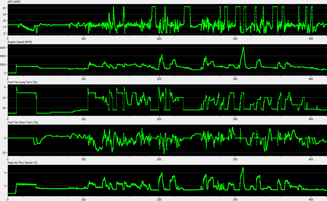

Hi fellow JRSC owners, I need your help. I already mentioned some time ago that about a month after the SC install I got P0172 fault code - System too Rich (Bank 1), and someone else confirmed they had the same. The code appeared a couple times, then for a while everything was fine. Then it started appearing again. It appears together with a noticeable change in the car's behavior - it becomes sluggish when starts moving, the RPMs on idle are not stable. Recently the engine even stalled when I was backing up from the garage. I tried to clean MAF sensor, as it seems to be one of the common reasons in such behavior. It helped, but only for several days. Then I got the same symptoms: sluggish reaction to the gas and P0172 code. This time together with P117B and P1170.
I did some logging with EcuTek (got it with JRSC kit), here is the data, and here are the graphs:

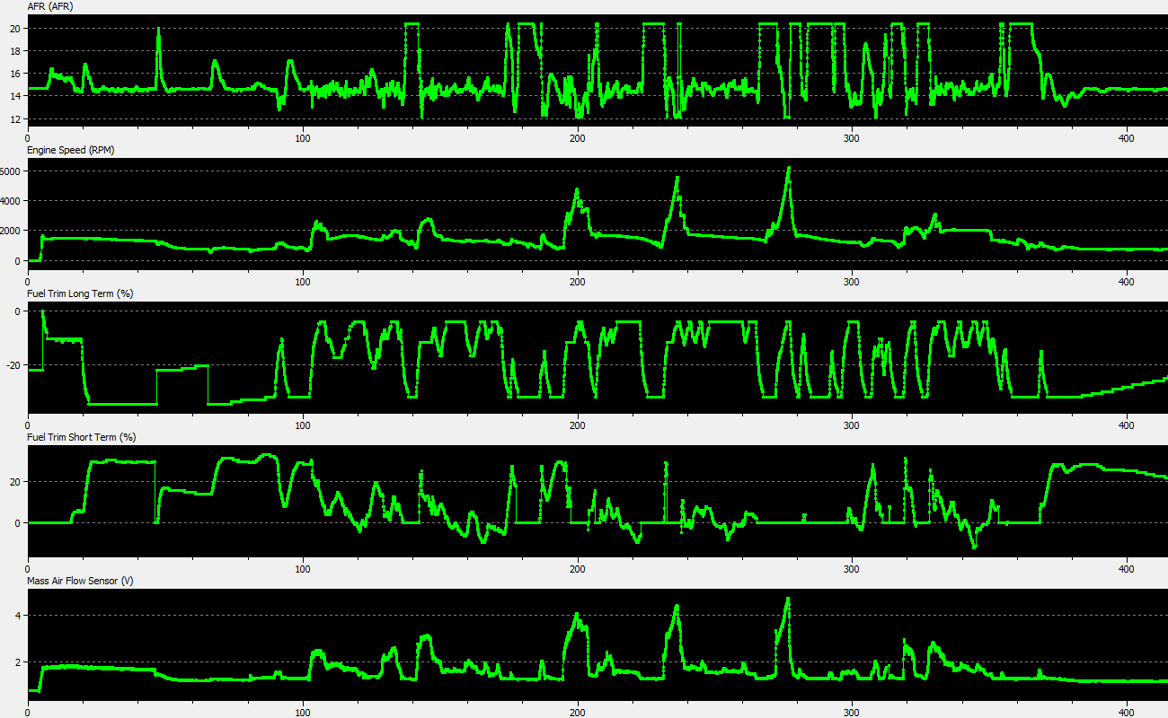

The second one was taken after I cleaned MAF again:

Can anyone get any clues from this - what the problem might be, and how it could be fixed?

Those fuel trims look off to me.
Attachment 104071
Attachment 104072
Thanks!
I battled similar issues. Fuel trims were terrible. Car almost died a few times, sluggish behavior, etc. I spent 6 months trying to figure it out. Finally found it was the God damn maf oring. It just became stretched out and leaked.
