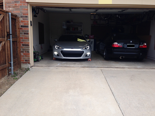

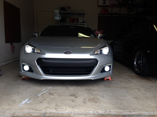

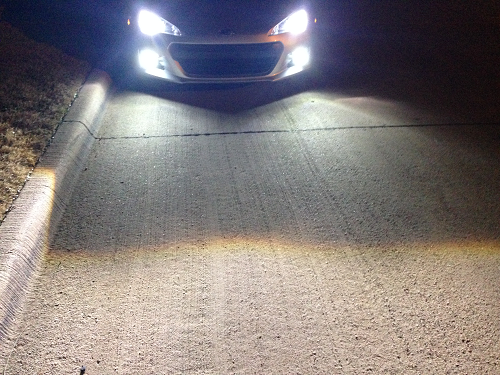

Husker BRZ
Go Big Red!!
Drives: 2013 SSM BRZ Limited
Location: TX
Posts: 515
Thanks: 489
Thanked 196 Times in 120 Posts
@KelvinBRZ @PandaSPUR
Here is a pic of my 6k headlights: (I know it isn't the best picture but it gives you an idea, I'll add a night time one tonight.
Name:  pictures from phone 011.png
Name:  pictures from phone 002.png
Size:  387.3 KBName:  pictures from phone 005.png
I will say the light isn't as effective as 4300k, that being said I think I will be trying the 5k lights in the near future to try and get more actual use out of the light. I don't dislike the 6k, but I think the 5k gives you basically the same aesthetic look with more functional use.
While I was out there I checked my module and tried my lights on auto, in neutral, and the car running and.... voila
