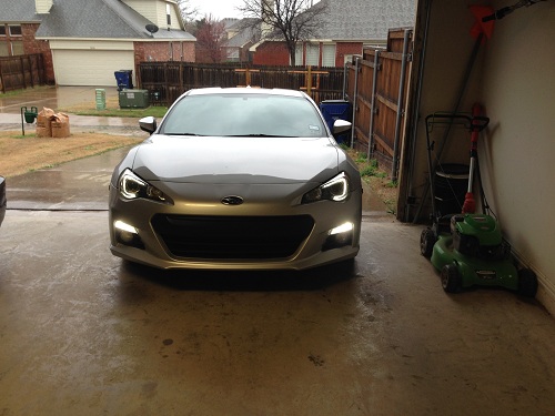

So you want it like this for your DRL?:
Name:  pictures from phone 030.jpg
To get the DRL strip on bottom off while headlights are on you need to remove the little red piece on the black module that is close to the little white hole on the bottom half. In their installation video it shows you at the 3:34 mark!

Damn thats a sexy picture, as simple as it is.
Cant wait to get this mod installed.
