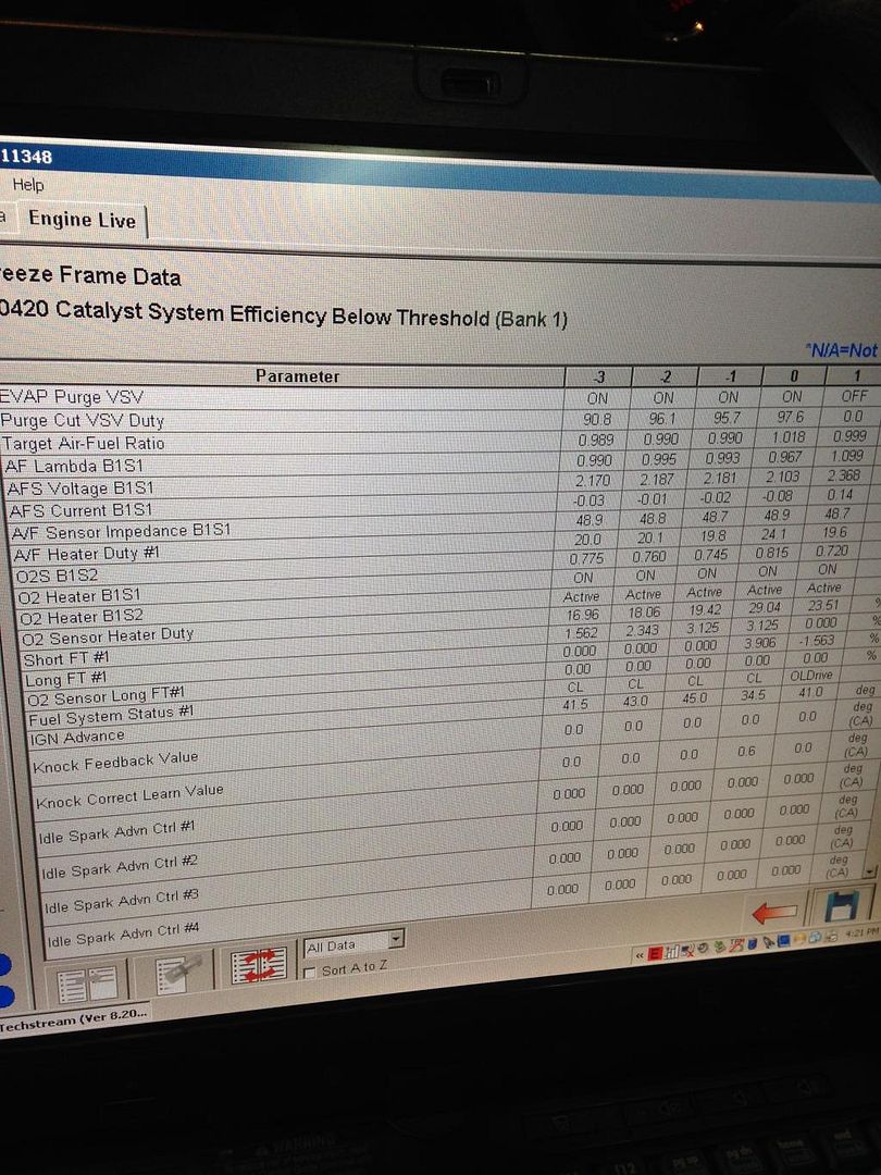

P0420
My car's got the header, an overpipe, and catback. A cat efficiency fault can't result from increased airflow, right?
Originally Posted by FT-86 SpeedFactory View Post
The catted header was only tested ( as that is what the community asked for ) on a stock car to not throw a CEL. If you start adding other bits like intake, exhaust and etc you start to mess with the volume of the air moving through the system now which can throw CEL's at the cat then.
You definitely should get a tune if you are doing multiple mods.
-Jeremy
I'm pretty skeptical that other mods can cause a cat efficiency fault. Be that as it may, I'm not uninterested in a tune. You mentioned a long while back that you offer a tune specific to this header. Where might I find that?
EDIT: lol the official Toyota scan tool says 'bank 1' oxygen sensor. That's not even close!
My FR-S has a build thread!
(It's mostly full of Nissans)
NissanGuy is offline
The Following User Says Thank You to NissanGuy For This Useful Post:
Teseo (02-23-2015)

Originally Posted by NissanGuy View Post
P0420
The toyota tool is a universal tool for many cars v6 models for example have 2 banks of cylinders. In our case we only have one bank so it refers to bank 1.
It still possible to get the p0420 code on catted header if the cat characteristics dont match stock cat, which is what the ecu is looking for. It compares the reading from the 02 sensors either side of cat in header under certain circumstances to determine if its working to spec, exactly what and when the ECU looks for I don't think anyone other than toyota/subaru know, it possible that additional mods may cause the ECU to see readings outside this spec and cause it to throw the P0420 cel code. Even on catless header the code can take many miles or weeks to show up.
Or more likely you have a gasket leak, crack in header, or leak at 02 sensor if no one else usually gets that code with this header.
if you did not do as below that may be the case. however the only 100% way to not get the code is disabling P0420 in ECU
Tips for changing header
1. Always use new gaskets, if you re-use the old ones it will leak causing 02 sensors to read incorrectly
2. Run a thread tap or chaser (M18 x 1.5) through you new header 02 bungs to clean them up , 02 sensors should screw in by hand. If you force them they are easily damaged and the threads on 02 sensor easily stripped.
3. Put high temp anti-seize on header bolts and 02 sensor bung threads, DO NOT get any grease or anti-seize on sensor tips, once contaminated they are stuffed.
4. Leave the 02 sensors in the stock header until you remove it from car then remove sensors. Just disconnect the plugs an tethers on wires as per picture below.
5. Black plug to black socket, grey plug to grey socket. and remember to plug both back in.
6. Use correct torque for bolts and o2 sensors, re-torque after a heat cycle.
I admit I didn't re-tap the holes or use anti-seize, but I've actually replaced all the gaskets twice (lesson learned: Grimmspeed literally blows), and followed up with a smoke test to verify no leaks. Apparently this fault code (nominally for a stuffed cat) happens to a lot of people with this header.
You could try those 02 spacer defoulers but the rear 02 is a bitch to get to without removing header.
if your thinking of a tune in near future it the best way and will have other benifits.
read the likns below if you want more info on tuning ect.
