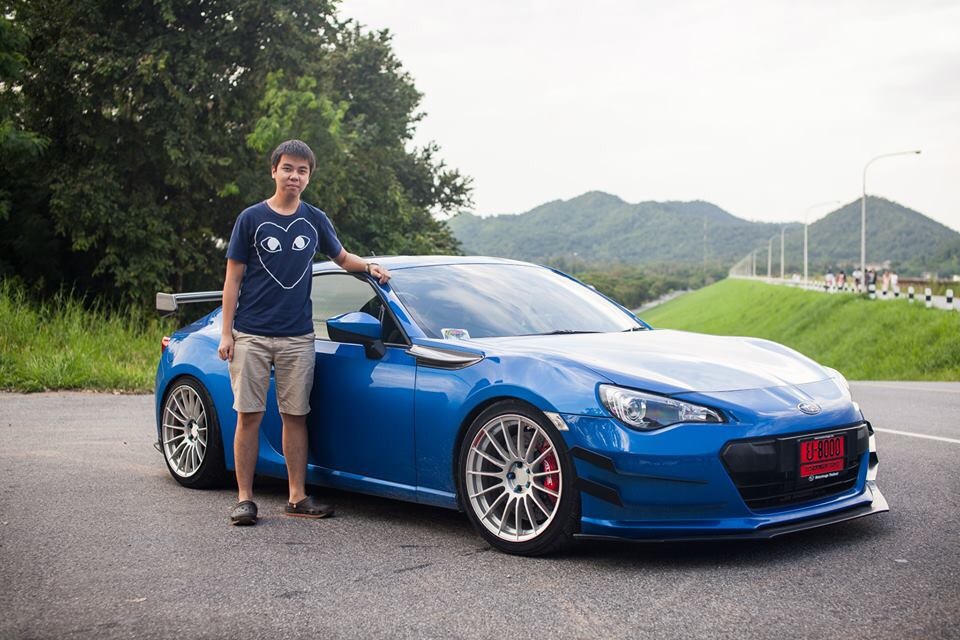

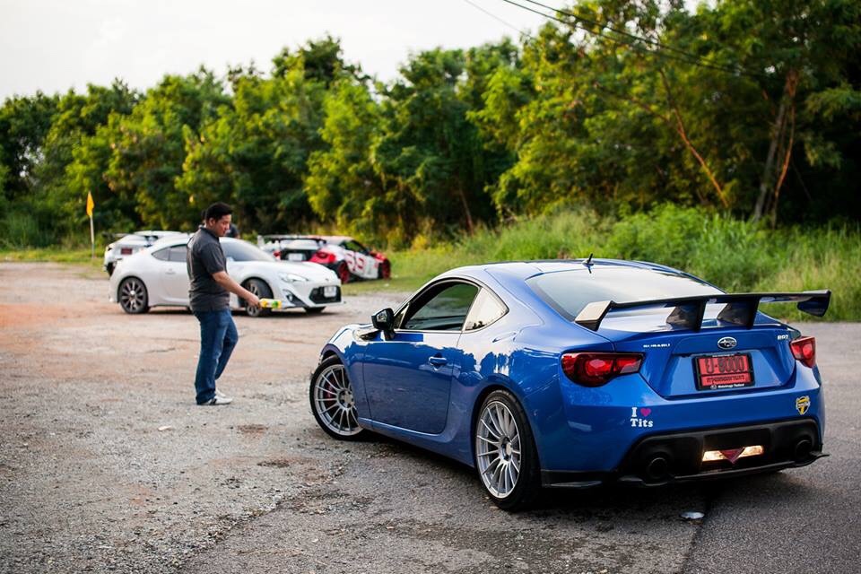

All the pics here are the stock setup with Eibach lower spring dude.
I changed the wheels and the lower spring at the same time, so I dont have any pic of the car with the stock spring.
