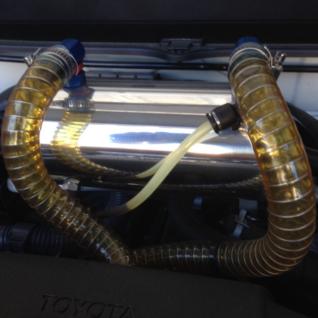

Originally Posted by mit_peid View Post
I have a single can only on the PCV side and noticed this morning that it is actually doing something. Worthwhile $100 investment I think. Attachment 98089
I have the same can with stainless steel wool stuffed inside to provide some baffle. I can confirm it collects absolutely nothing in my N/A application.
Originally Posted by Wes View Post
i didnt collect anything in my cusco one, so i just sold it after a year lol
some other ones actually seem to catch blow by though..
where else would 6 oz oil go in 1 day?
