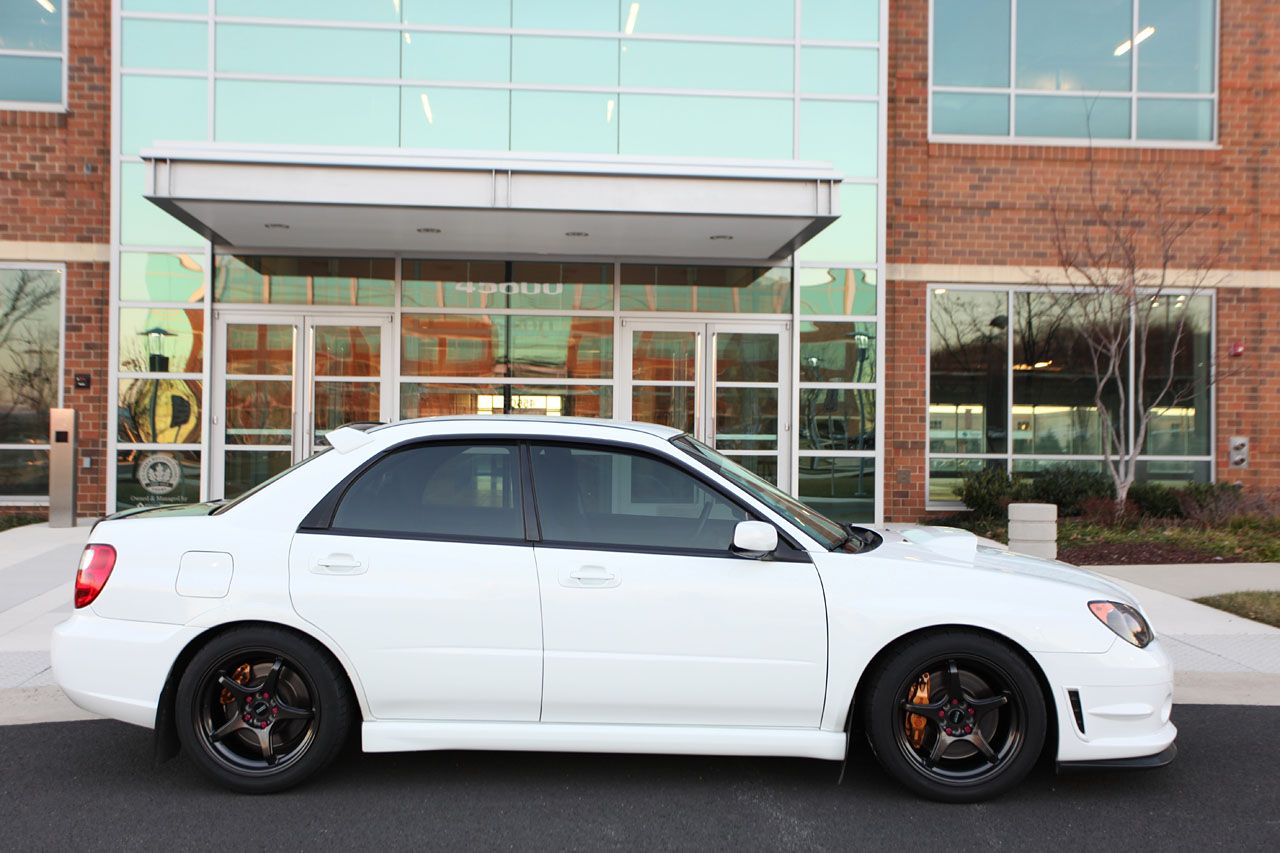

Originally Posted by Foobar View Post
Mach V Awesome's should clear as well.
They do.
