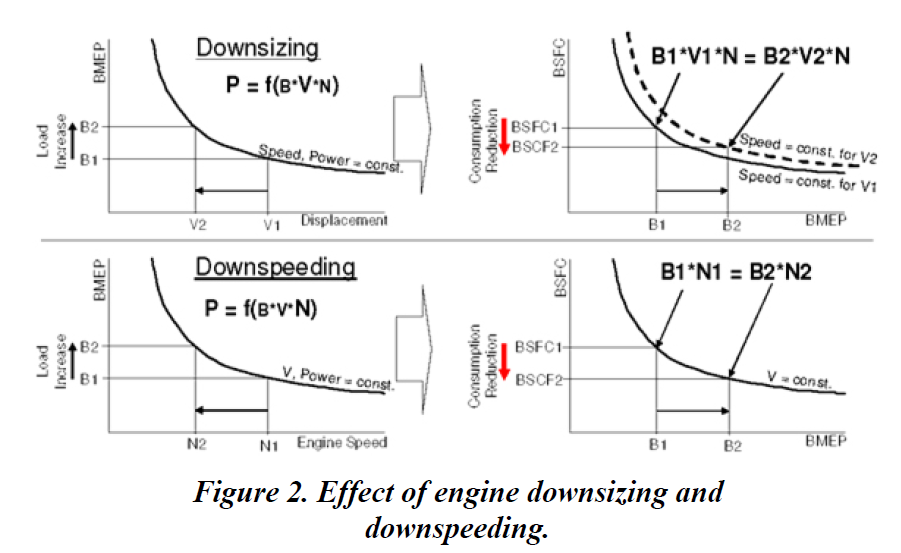

The chart below is from a Delphi study on downsizing + downspeeding:
Here are the basic trends and relationships to understand.
1. Brake specific fuel consumption decreases at higher load and lower speed according to a basically logarithmic-looking curve.
2. Engine output is a function of displacement, brake mean effective pressure (load), and engine speed.
Therefore...
3. If we keep the engine speed the same but decrease the displacement, we must increase the brake mean effective pressure (load) to maintain engine output. Lower displacement means higher brake mean effective pressure to achieve a given output, which means lower fuel consumption.
4. If we reduce the engine speed, we must raise the brake mean effective pressure (load) again to maintain a given engine output. Raising brake mean effective pressure due to downspeeding reduces specific fuel consumption again.
The boosting system does present its own set of issues but downsizing means reduced pumping loss and reduced cooling loss relative to larger engines with more cylinders.
Certain tricks with cam phasing can also reduce pumping loss (late intake valve closing). The use of high levels of cooled external EGR (not sure if this engine uses it) essentially works as knock suppresant.
