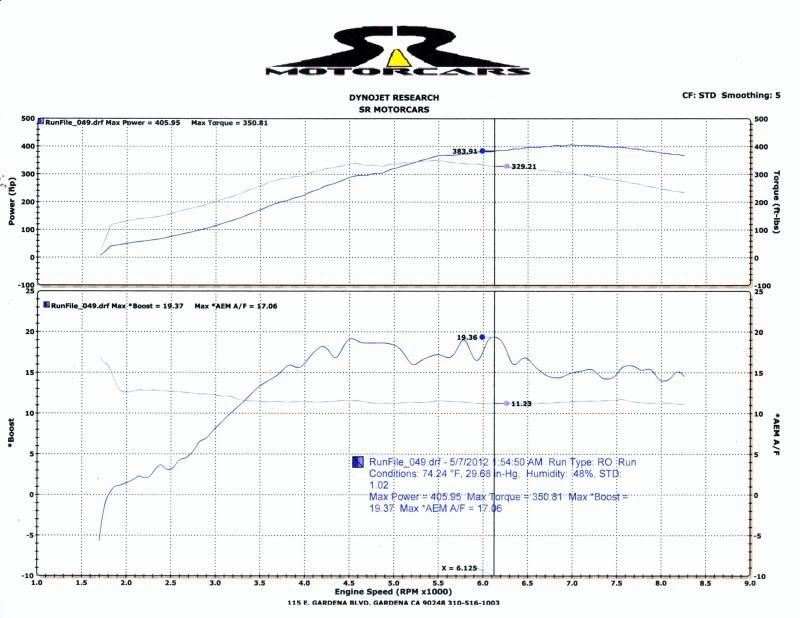

ummm....not the same motor....
besides that, if you are still fixated on SC's you haven't been paying attention to the latest Turbos...for instance this is my 2.0L SR20
notice it makes 8psi by 3000rmp and that's without using the top wastegate port to assist spool up...
also makes 260whp on 6psi wastegate pressure

It's not about the torque curve... Turbos typically have poorer throttle response. The actual spool up time can make throttle modulation difficult. Enought to possibly upset the balance while navigating a corner (at the limits, on a track). I know there are some methods to reduce this response time, but I don't think they will be appearing in daily drivers any time soon. You'll never see throttle response on a dyno graph, since it's floored the whole time.

correct, but I drove it. and while it isn't NA with ITB's quick it will melt tires before the pedal hits the floor and you can get back out...in 3rd gear.
low end boost helps to represent what the throttle response will look like.
