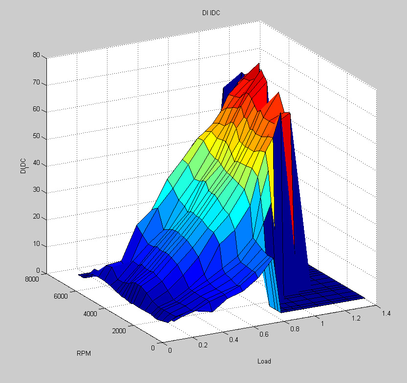

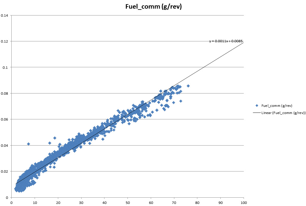

This one is interesting and not much info available. I have made quite a few assumptions here in the absence of hard data on Toyota's DI system. Do your own verification before using these to tune your engine...
Since DI only has one rev to work with for fuelling rather than a whole cycle: at an 8000 RPM redline, there are 7.5ms per rev rather than 15ms/cycle that the port injectors have to work with.
I looked at a number of relationships betweek DI_IPW and load in log lines with Port_IPW=0 and found the most linear relationship with the commanded fuel vs DI_IPW*FuelPress:
Commanded Fuel fuel g/rev
= Load air g/rev / Commanded_AFR air/fuel
From what I understand, most DI injectors have up to a 5ms pulse width time. Flow is also proportional to fuel pressure. Luckily for us, the peak DI IPW is 5ms and peak DI fuel pressure on the GDI flow table is 20MPa. Multiplying the peak DI (5ms) and peak fuel pressure (20MPa) essentially gives us a 100 % value that we can use directly.
Scripts will be posted in the MatLab thread.
Figures:
1. Relationship between DI_IPW*FuelPress vs Commanded fuel

Interested on the DI cycle. I run far more DI than the stock setup, my S/C runs about 5.8ms on the ECUtek logs at the higher RPM, compared to ~3.5ms for stock. Is there any way to calculate this at all?
You can log the PI duty on ECUtek although I currently don't....

You have to start thinking in terms of crank angle degrees and injection window. On PFI, the fuel can build up on a closed intake valve or spray into an open intake valve. For open valve injection, we can say you've got the full 720 degrees to inject PFI fuel. That's 100% duty cycle. The start and end of injection don't matter at that point.
For DI it's different. In one sense, pulsewidth doesn't matter as much assuming a fixed rail pressure. You're limited by your injection timing window. For max injector flow you can't spray when the exhaust valve is open, or rather you can but it will go right out of the cylinder and be useless. You've got from the start of injection time until a maximum of when the spark plug fires. So if my SOI is 320 BTDC, and my spark is 20 BTDC, I've got 300 degrees window (oversimplifying a bit). The number of corresponding milliseconds varies with the engine speed.
For DI: log your SOI, log your milliseconds duration, calculate your crank angle duration from that, and then calculate your end of injection. The closer your SOI gets to 360 BTDC (top dead center Intake), the more you are hosing down the piston and/or cylinder wall, getting oil dilution, smoke, and other kinds of problems. The same applies to the EOI: the closer your EOI gets to 0 degrees (top dead center Firing), the more you are hitting the piston and/or diluting the oil.
But even if you don't give a crap about hosing down the cylinder and the piston, you still can't throw fuel out the exhaust valve. So your DI will never get anywhere close to 100% duty, because my exhaust valve is open for 200+ crank angle degrees. From what I've seen typical stock tunes don't run more than 200 degrees injection duration on DI due to concerns about smoke and oil dilution, but as I said that can be stretched.
I haven't looked at SOI parameter, but it does make sense that the injection window would be (SOI - spark timing). We'd have to assume that SOI and spark would be referenced off BTDC in the ROM.
Does anyone have the RAM address for SOI?
Kodename47 has had up to 5.8ms on the DI injector - anyone else gone higher?
