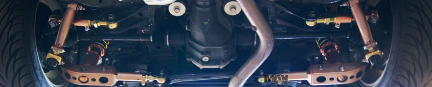

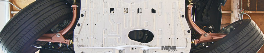

CHECK THIS SHIZZ OUT!!!!!
http://www.partsshopmax.com/page.php?59
FLCA and FULL SET of rear arms coming soon!!! WOW look how straight those axles are!!!!!
love me some PBM...

Originally Posted by JordanWho View Post
The most promising info we've had on this issue.
i pass by the Powered by Max shop every day to/from work, so i will stop by when i get back from deployment to ask if they can just weld a stud on the factory lower arms for the sway bar.
that way we dont need the entire angle kit just to stop the link from binding on the strut.
if so, there will be much rejoice!
*or we could just ask on their forum?
http://www.partsshopmax.com/e107_plu...c.php?10166.20
