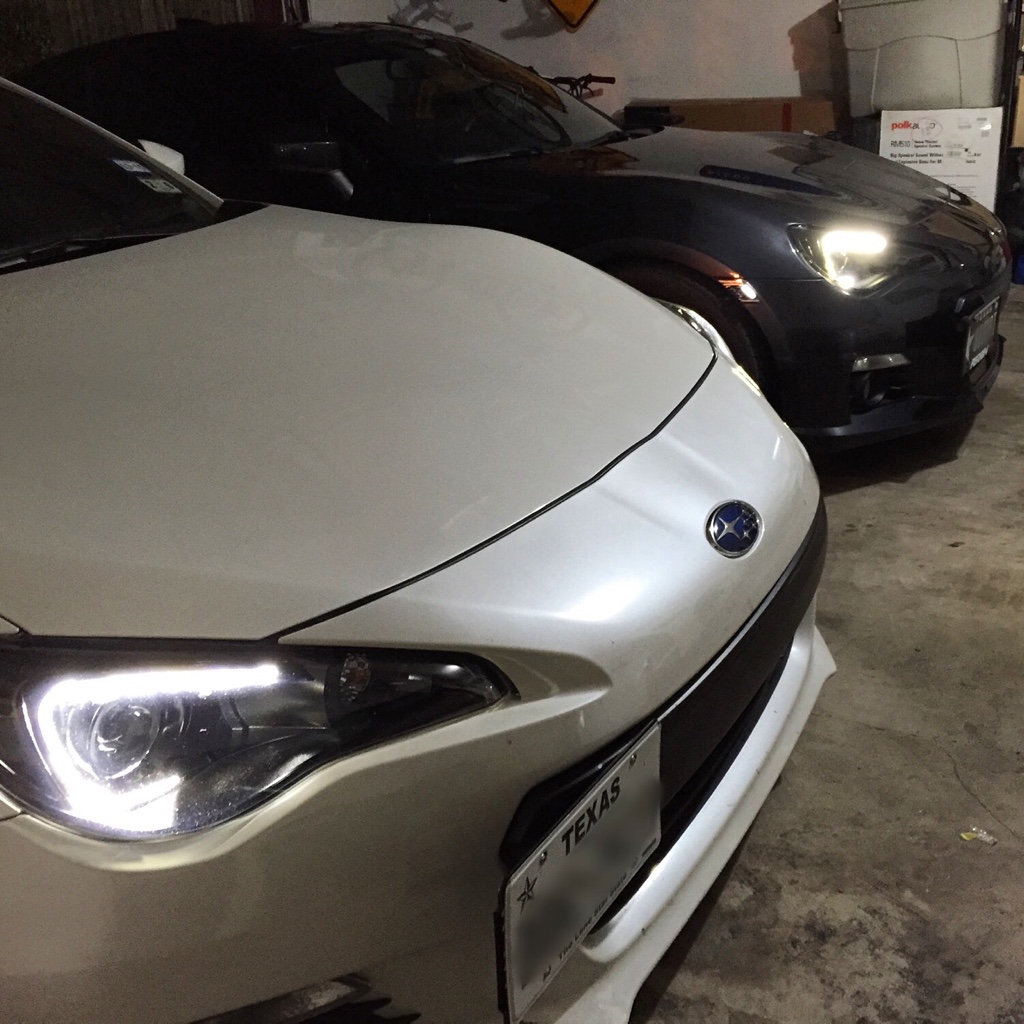

DIY - BRZ Boomerangs - Brighter, Better
So we did the last two BRZ's of our "brightening components" group buy yesterday. Along with blacking out the internal headlight housings. That's a total of nine BRZ's that we have successfully completed this boomerang upgrade on, with no issues. It's to the point where I could literally do this upgrade with my eyes closed...
Big thanks once again to @Acree for the great DIY write up
