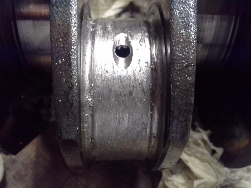

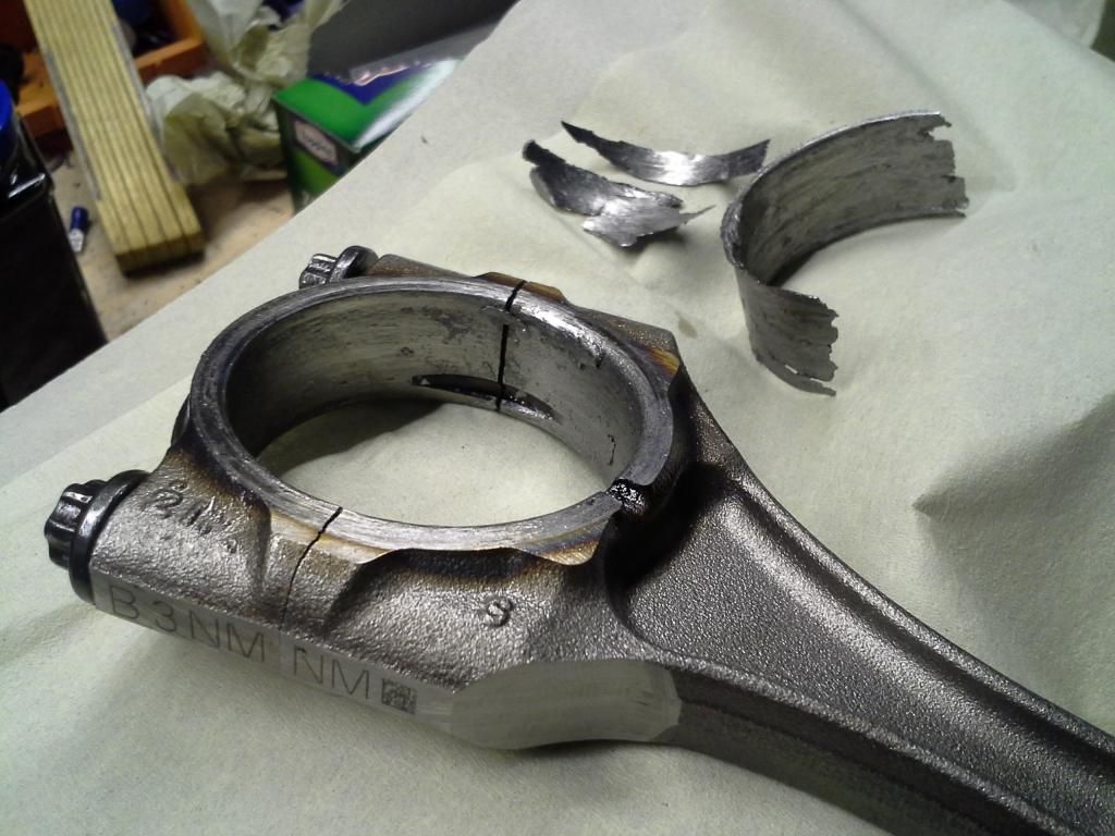

I finally got the engine out to inspect the damages.
Second connection rod bearing was spun.
Luckily the rod was still in one piece and heads and case look ok.
So I might be good to go with a new crank and a rod.
I would love to have the internal modifications done to ensure sufficient oil pressure.
But sending the motor from Europe to USA and back is probably going to be pretty expensive.
Andreas83 is offline   Reply With Quote

Wow, did this happen in NA form?
If you look back to my original post you'll understand why this one rod bearing went first as it appears to be one of the two rod journals with shared oiling source.
What oil brand, weight, and pressures were you seeing?
Expensive to ship, yes but not as expensive as it will be if it happens again. You'll just have some options to figure out in terms of just shipping heads and building up a new bottom end or stripping down what you can and sending that. In the end if you do get sent back a rebuilt engine you will save on import duties for sure. We are always helpful on that however with international engine shipments.

Yes, the car is NA, its the second rod.
Valvoline 0w-20 oil, I dont have a oil pressure gauge.
Happened the day after oil change at my dealer, but they wont cover it due to mods.
