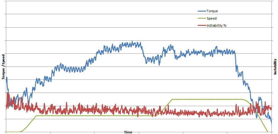

First of all, great post. Thank you for your input. I am trying to get my head around all the info here and the other threads linked earlier. One thing I was curious about is, what exactly does "better combustion stability" mean?
You'd think an engine makes some amount of torque but that's constantly jumping up and down. It's usually worst at cold start, when pulling spark to reduce knock, and part load where it's being choked down with internal EGR for fuel economy. The ugly zigzags you see on a dynojet sheet are sometimes noise but there really are torque fluctuations. If they're bad enough you'll get hesitations, surging, and misfires.
If one were to manually control an engine on an engine dyno, holding speed with loading, one might see all sorts of fluctuations in torque and combustion pressure. Then one's software could calculate an instability % which corresponds to these fluctuations in torque or combustion pressure. It might look like this, with the bigger changes corresponding to same change in some parameter you are tuning...
so is the torque really say 100 lb/ft or is it 100 +/- 5% , or 10%? Is it bad enough that a driver could feel it, or even bad enough that you start getting misfire?
The thing that's relevant to the debate is this: DI can cause poor combustion stability if it's not mixing correctly. However, it relieves knock, and that means more advanced spark and with the right heads probably faster combustion speed.
More advanced combustion due to knock relief improves combustion stability. That's a + for DI.
Poorer mixing due to injection timing and mixing time hurts combustion stability. That's a - for DI.
More retarded combustion due to spark retard for knock hurts combustion stability. That's a - for PFI.
Better mixing due to vaporizing the fuel in the intake port and having more time improves combustion stability. That's a + for PFI.

Let me point out that combustion stability perception is kind of relative. When you see a V8 camming, it's having poor combustion stability at idle and low load. It still sounds cool though, even if it's burning poorly.
Likewise when you drive down the road in a modern engine you will have higher instability at part throttle due to dilution with AVCS induced overlap. However it's not unstable enough to notice usually, and you are getting better fuel economy.

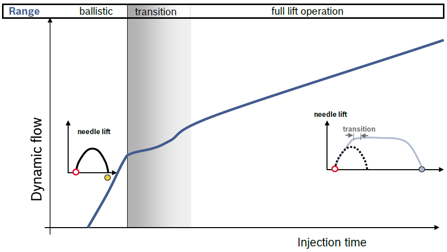

Solenoid injectors have a linear and non-linear range of operation. On modern PFI with saturated injectors (voltage controlled) it's simpler because the current and voltage control are simple compared to the old "peak and hold" injectors from the 80s which used a burst of current to open those clunky 80s needle valves and then a lower current to keep it going. The old peak and hold control lives on in solenoid direct injection, but it's more complex (see below).
So basically on modern PFI there's a bunch of stuff in there to translate pulsewidth into mass flow, based on the characteristics of the injector and on the environmental conditions (air temperature, water temperature, etc).

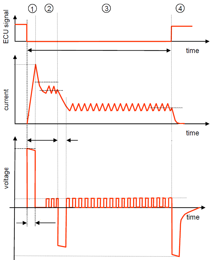

The direct injection is more complicated because they are run with peak-and-hold current control and booster voltage. They also are much trickier to control at low pulsewidths (typically under 1 millisecond). You have to have an injector flow vs pulsewidth model in the code with a bunch of look up tables populated by bench tests and engine dynos for the most part. The basic intellectual property is owned by the supplier and then adapted to the application.
With a lower flow DI injector, you flow less and don't need low pulsewidths so much. You spend less time in the "ballistic" non linear range, where the valve opens and closes like you are lobbing a Hail Mary pass at the end of the Super Bowl.
So when the DI injector is being driven, you have 4 basic phases:
1) booster voltage phase -- a bunch of current and voltage applied to open the injector quickly
2) high current holding phase - current dithers at a high level as the injector reaches full open
3) lower current holding phase - the majority of the on the time when long pulsewidths are used. the split between high and low current hold has effects on injection noise and behavior of the spray pattern, especially with respect to emissions
4) closing phase - sort of the inverse of the boosting phase
So the ECU signal is the pulsewidth, yes, but there are all these separate sub-operations going on within that pulsewidth that are in separate modules of code with a bunch of lookup tables and settings controlling them. The fuel mass model can calculate flow taking into account all this complexity.
