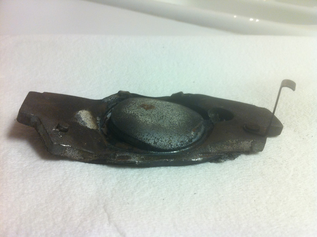

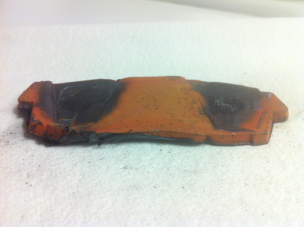

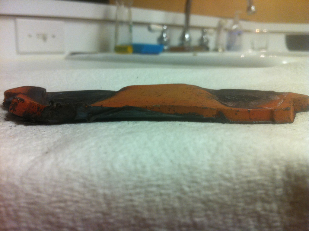

I'll let some brake engineers explain it, JRitt has someone on staff I'm sure. They can do a better job then I can.
Force via caliper *BODY* movement vs caliper *PISTON* movement is the difference. Given the same exact piston area, brake force is the exact same (everything else being equal).
The key benefits of fixed calipers are feel, modulation, and pad wear (less tapering as force is applied more evenly across the backing plates).
This is from my race car. Sliding calipers can exert PLENTY of force on the pad:
And so can the piston
Holy Shit..............!!
A little heat??
