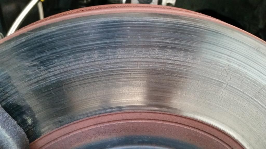

In regards to the attached picture, what exactly is going on with my rotors? My guess would be heat stress from the track but is it something to worry about or just natural aging of abused parts and monitor it? Does it mean it's getting close to the time to replace the rotors?
The small cracks are heat checking; normal. The whiteish non-reflective stripe looks like a pad just about to start smearing (literally smearing, because it's overheated and melting).
The rotor is fine to use, but as the cracks get larger, get ready to replace them. If a crack reaches the edge of the rotor, it's no good, and needs to be changed ASAP. You'll feel a pulsing your brake pedal if you drive on a cracked rotor.
Got it. I guess its a good thing I ordered those 999s then; can't wait to try them out. Would it also be appropriate to ssy that I should look at getting some ducts to cool the brakes too?
Ducting will help prevent fade, but it comes at the cost of speeding up the process of cracking rotors, since you'll be making the thermal cycles larger.
It's definitely something to keep in mind.
Ok I never thought of that but makes sense.....related then, when it comes time to replace the rotors, is it worth it to just go with a blank replacement rotor or upgrade to something a little more geared toward track duty (still keeping stock brake system)?
