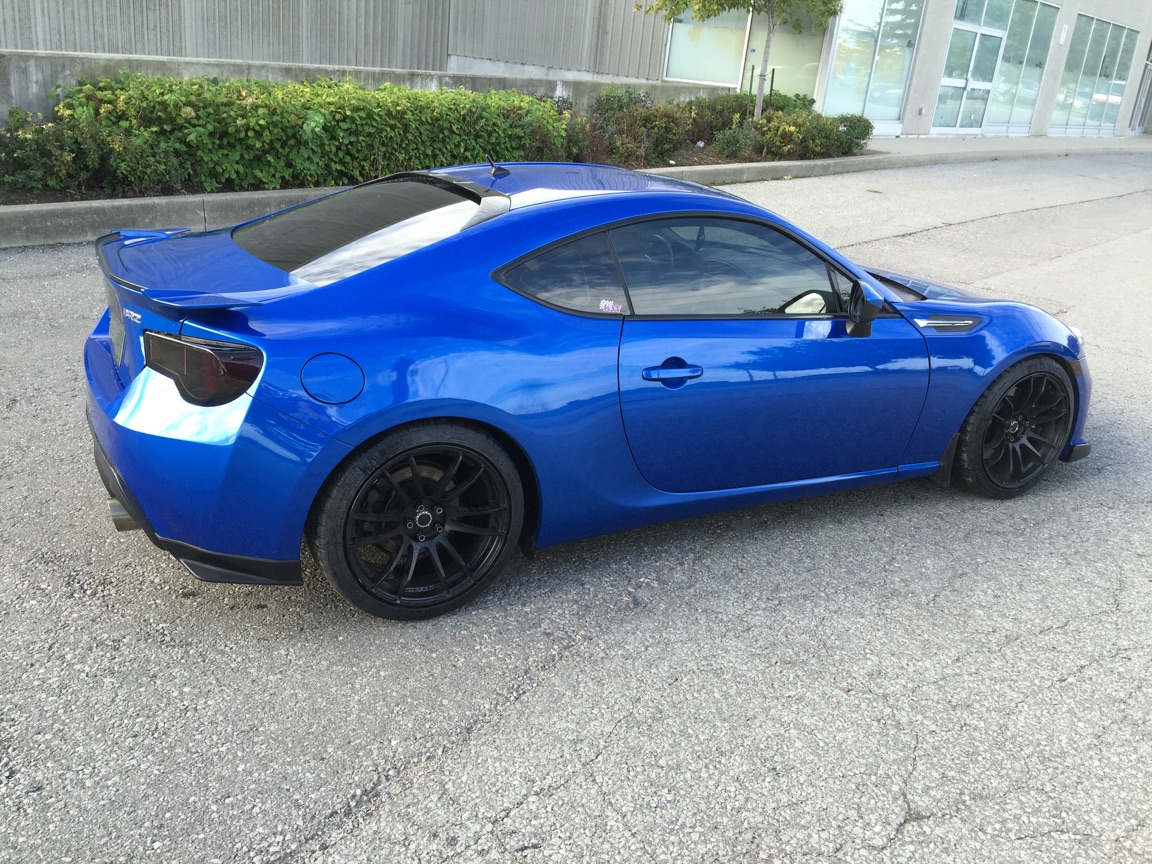

you mean that you want them to come out like this?

How did you do this? And how much light goes through during the day? Is it bright enough?
