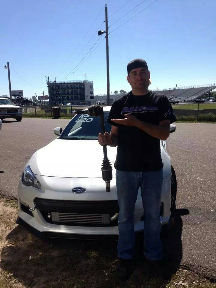

Add me to the list
498whp
I was attempting to run 10's
Lowered on h&r super sports
43,000kms
Turbod
Drag and drifting
Does anyone know the torque spec for the axle nut?

Old 09-08-2014, 12:37 AM   #151
cnk
Drives: '13 DGM BRZ Limited
Location: NJ
Posts: 1,202
Thanks: 59
Thanked 547 Times in 339 Posts
Originally Posted by Dipstik-sportech View Post
Add me to the list
140.1 ft-lbs
