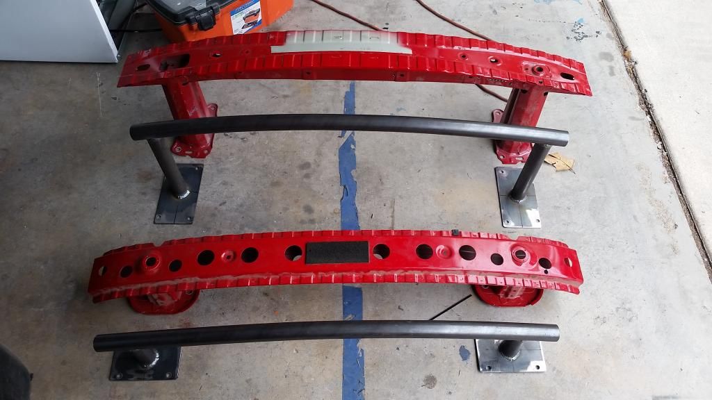

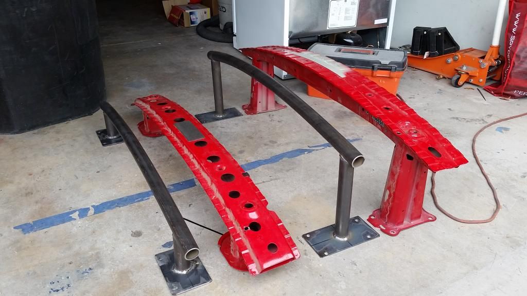

Hi all,
As most of you know, we are going to all measures to lighten our race car for the United States Touring Car Championship series. Urban Metal Werks in Las Vegas did an amazing job on our race car's roll cage - so we came back to them with another request.
They have created drift bars to replace the OEM crash beams for the front and rear of the FRS/BRZ.
I wanted to see if there is any interest for these to go into production. Mine are made from chromoly and we saved 8 lbs. To take down costs, they would sell in mild steel for about $150 each. Any interest? Post up your thoughts.

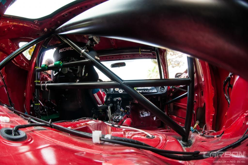

And here's an updated photo of my cage, just for reference

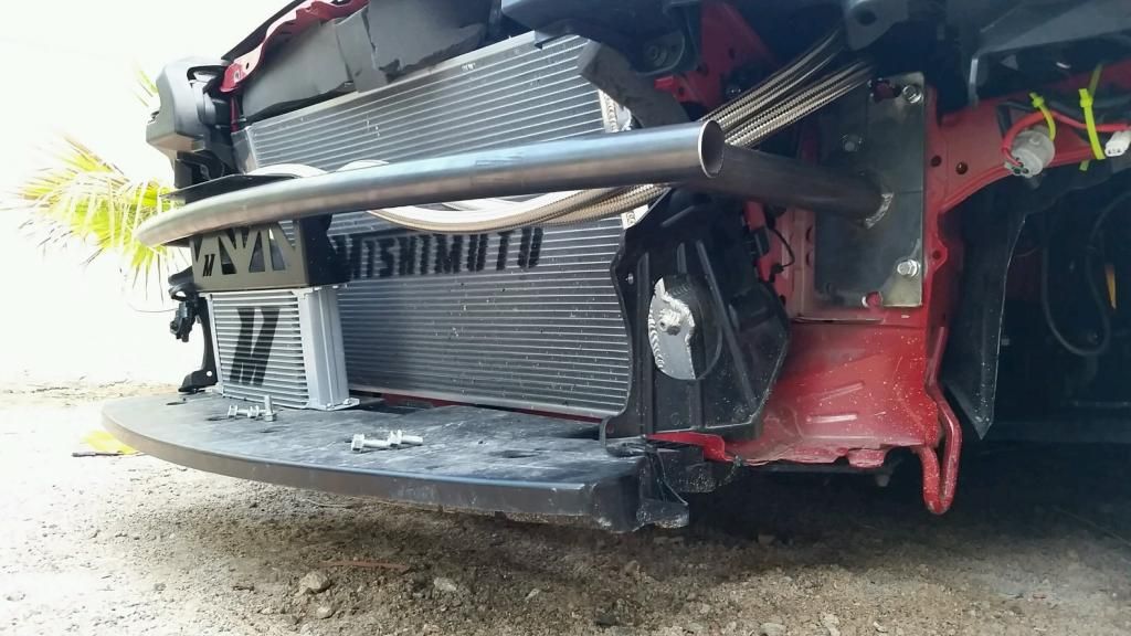

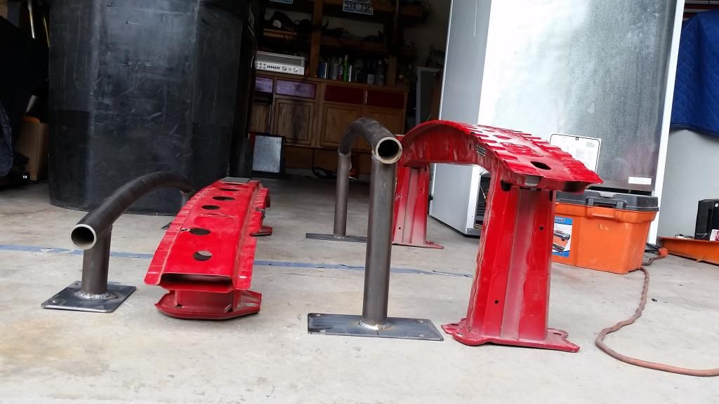

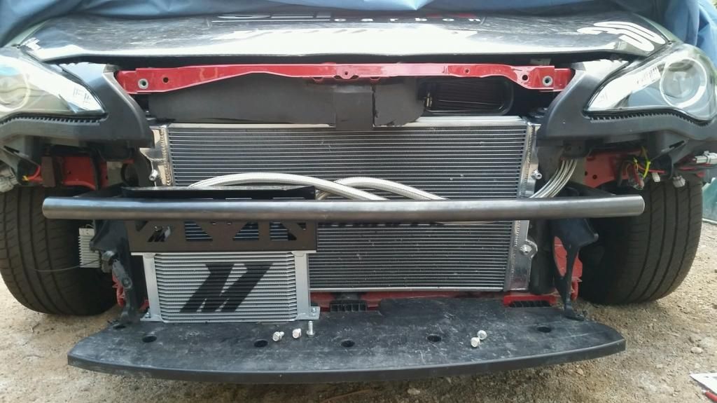

Edit: heres a shot from test fitting the front - still nailing down the mounting plates

Could you please tell me what the purpose/advantage of these are? Just curious
I'm guessing lighter and more room for coolers and shit up front
Because race car...
lol jk.
weight reduction
rigidity/chassis strengthening
easily replaceable if contact is made
frees up space

I have the similar Drift Armor bar in front, and this type of front crash bar allows a LOT more air into the front.

Originally Posted by mike the snake View Post
...this type of front crash bar allows a LOT more air into the front.
This.

Originally Posted by rs999 View Post
With these the car really only becomes racecar since I doubt these drift bars were nhtsa or crash tested at all for daily public road use.
Also, the stock bumper beam has crumple zone. A solid steel framed bumper bar will transfer all the energy through to the frame and is more likely to cause more irreparable damage.
But then again, if you go to this extent, you should have the *real* need for it.
I'm not a structural engineer, so please correct me if I'm wrong.
That would be just as bad for a race car as for a street car. Properly designed race cars are built so that the cheapest/most-easily-replaced parts break ahead of the major/expensive parts.
