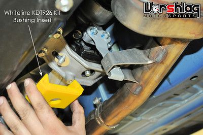

I seriously doubt that your issue is with multiple shifter manufacturer's. Your either getting the vibration from an installation error or vibration sent up from your exhaust hanger. You should stop blaming other people and get under your car and start troubleshooting. I would try to use some rubber gaskets at the exhaust hanger to try to insolate that area of contact or look for any metal on metal contact. I'm not saying that's your issue but it could be a possibility.

I seriously doubt that your issue is with multiple shifter manufacturer's. Your either getting the vibration from an installation error or vibration sent up from your exuast hanger. You should stop blaming other people and get under your car and start troubleshooting. I would try to use some rubber gaskets at the exhaust hanger to try to insolate that area of contact. I'm not saying that's your issue but it could be a possibility.
Ah ha. That's a new and good call - the hangers are stiffer and provided by Nameless when I put on their exhaust. I am not "blaming" anyone. I have only pointed out that both brands rattle and the stock one doesn't and that this is a flaw.

Here's a clear picture of the exhaust hanger I has talking about
