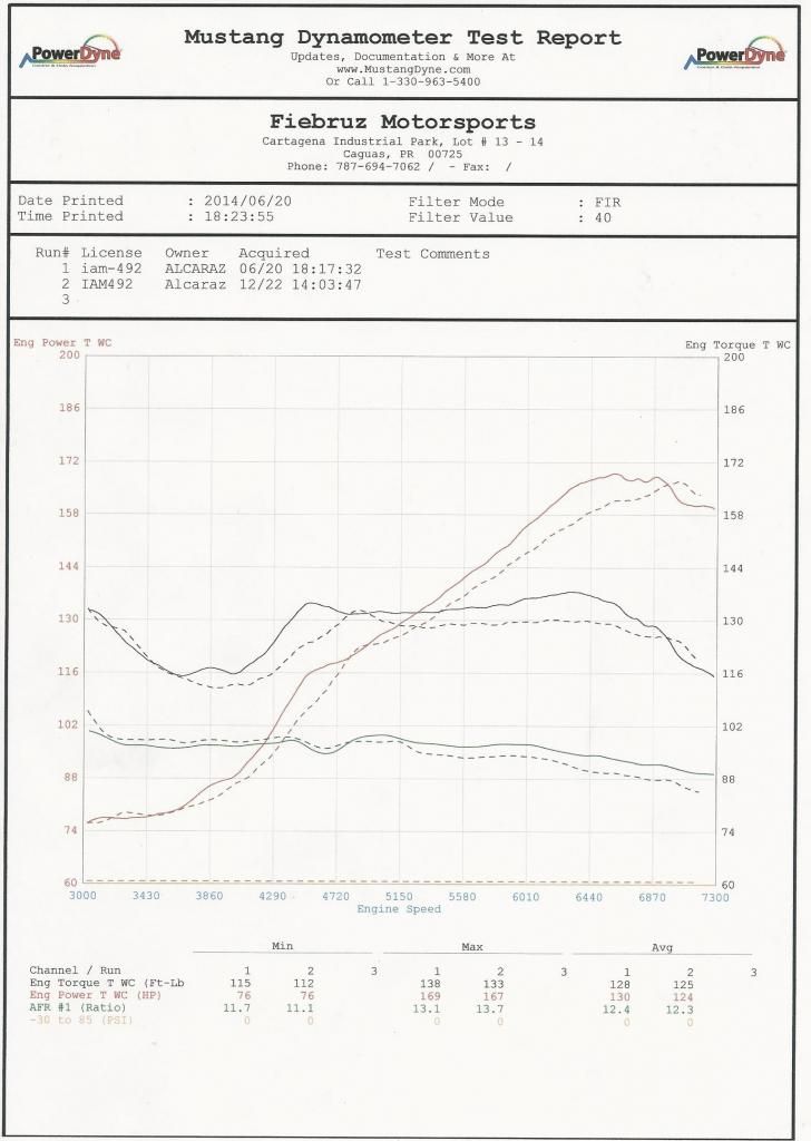

No you don't... this is a intake spacer kit made by my local tuner... my car untuned before and after intake manifold spacers
You lose a bit at the top end... but then again I rarely shift at redline even at the track.
