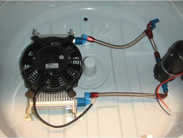

Originally Posted by gramicci101 View Post
For the rear diff, what about some of the aftermarket diff covers that increase capacity and have cooling vanes? Would that be sufficient, or would you need an external radiator?
Does this car log diff or trans fluid temps, or do you need to add your own sensors and logger to find out if radiators are needed?
If fluid expansion is an issue, a vent can be added to relieve the pressure.
It would be great if a radiator could be avoided short of endurance racing. I'd want to avoid the complexity and noise that a system like this one would have.

No trans or diffy sensors on this car that I know of. 99% sure.

I also have not seen any PIDs for tranny or diff in DashCommand (even for the auto). Engine Oil temp is the only one.

Both the aftermarket diff covers on FT-86SF made a point to say that they included ports for temp sensors and fluid coolers. That makes me think that it's not included on the OEM setup.
