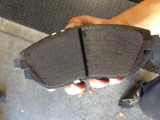

I just got my ST43 brake pad and just found out that they are made by porterfield!?
its using the Porterfield box but it said St43 on the side. is your like that as well?

i was going to install them then find out...they made a wrong size one..... its like one size bigger. Now I don't know what to do, track day in 2 days.... FML

I just posted this in the Track Pad thread:
Originally Posted by rice_classic
I know some folks have been struggling to find a distributor for the "miracle" pads from Raybestos.
Call Tim at http://racebrakes.com/
949-548-4470
Excellent guy, can cut just about any compound in any backing plate. Spoke with Tim today. Gave him my feedback as well as getting some very good insights. I decided to buy another set of the Raybestos ST42 and try at set of the ST45s. I've also been having a backing plate sizing issue from other distributors I've ordered my pads from and he said he would alter the plate to suit my caliper needs.
Oh yea, the price I got from him was about $20less than anywhere else.
@mtsui: Call Tim IMMEDIATELY and tell him! I don't think he'll be able to get correct sized ones in time but how different are they? Take a picture of them and the stock pad for us please. You may be able to make them fit with a little time on a grinding wheel. The Raybestos Pads are the BIGGEST pads I've ever bought because they usually run the material to the extent of the plate unlike most other pads. We need pics.. post pics right away!!
@glamcem: You guys running a race-only pad on the street just blows my mind! Anyway, after using the 43's, if you feel you need a step up, you should try the 45's. I plan on using the 45's at the Ridge w/ NASA in August I tell you how they work compared to the 43.
The problem I have with the 43 is that half the time they put down an irregular transfer layer and I end up getting horrible shutter. Part of the reason I rarely have the luxury of actually bedding pads, I usually need to toss them in a GO! Tim at RaceBrakes (porterfield) said the 41s and 45 are much less prone to this.

lol, I don't think its able to grind it down, haha

Are you kidding me? That'd take me all of 10 minutes. The part in green probably doesn't need to be ground down if it doesn't touch the rotor hat.
I've done this very same thing with S2000 pads for my CRX. The S2000 pad is the same shape as my CRX caliper just slighter larger so I just grind it down to fit. http://honda-tech.com/showpost.php?p...4&postcount=15
Use a sharpie to outline what you need to remove and get to work.

dude, you're crazy I wish I had the skills/experience to do that I would probably ruin the whole thing oh btw, it may touch the rotor hat since it was a tight fit if I remember correctly
@mtsui
Skills schmills.. Go buy a $50 grinding wheel from Sears, some safety glasses and have at it. Seriously. Mark what you need to remove with a sharpie and just hold it to spinning grinding wheel until that part is no longer there. It takes literally no skill at all. Even the part that may contact the rotor hat, take that off too. Don't trust yourself? Grab a metal piece of something you don't care about and start grinding to get a feel for it.
The $49.99 one is all he needs 1/6th HP
