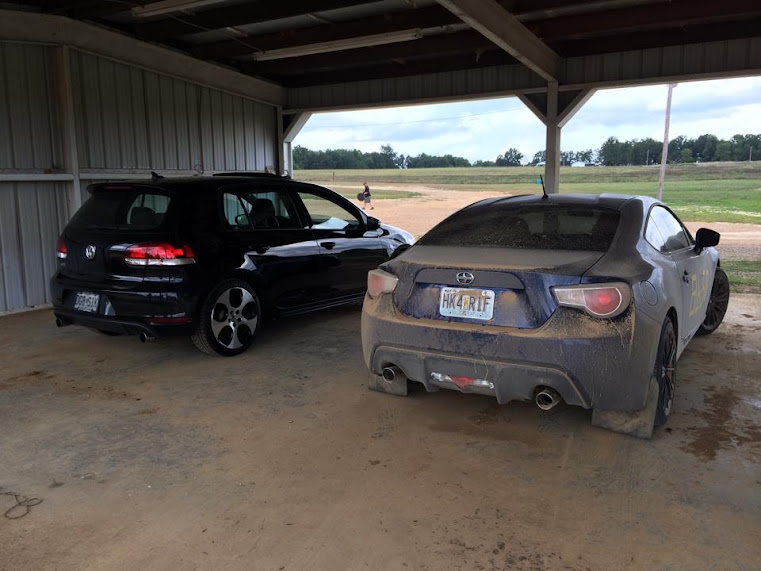

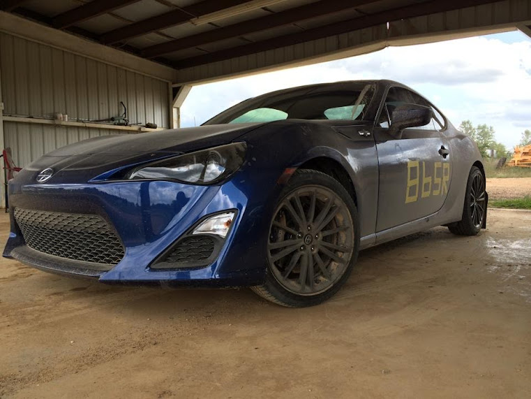

Great build man! And from the pictures above you seem to be using your 86 quite nicely :p
