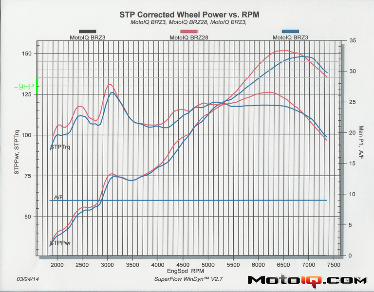

i have attached the dyno from motoiq but with some markings.
Attachment 71968
I want you to look over both. Note that the cursor on the crawford dyno is at roughly 6,359 RPM. This is showing the power at that RPM not the peak RPM. The 4WHP gain was "4WHP @ peak" Not "4WHP Peak gain". There is a significant difference. If you look at the green lines i drew thew are exactly the same size (i copy and pasted). This line indicates roughly 9WHP @6,200RPM gain. This is a rough estimate of the peak gain, not gain at peak. If you do rough estimates the right green line is roughly 149WHP. The baseline however shows roughly 140WHP. 149/140 = 6.4% gain. Mind you I am estimating numbers. As I don't have the original plot to use to verify exact numbers. And in fact I am WRONG here is a quote from the article:
So if this is the case then lets calculate our HP @ 6200.
126.2/5252 * 6200 = 148.9HP.
148.9 - 11.5 = 137.4
What is our % gain?
148.9 / 137.4 = 8.36%.
Now lets repeat this using crawfords dyno in which we have the numbers written on the chart.
206.11HP at peak gain @ 6359RPM.
187.88 baseline @ 6359.
What is Crawfords % gain?
206.11/187.88 = 9.7% gain.
So sure crawford saw roughly a 1.32% higher gain than this user. But thats pretty damn close.
This is a great example of "reading" the text from a dyno's gain reports vs actually analyzing the report. If you want to actually view gains via text it is best to use AVG WHP/WTQ gains to do comparison and use them in % not WHP. It looks like crawford is trying to use a compensation to compare to a dynojet or something of the sorts which is why their dyno is reading so high. Again if you look at their chart you will see AXLEPOW VS POWER which is corrected vs uncorrected. This is why simply posting "my car has xxWHP/xxWTQ" is rubbish. Because maybe you have a linear tq curve, or a flat tq curve and the difference is quite big when actually driving the car.
So what am I saying?
Yes I do see the 19WHP gain. If you were to get the same % gain that crawford saw you would see 13.3WHP peak gain. This article posts an 11.5 gain. This is fairly close.
If this is sustained post tuning then this is an extremely good power / $$ ratio mod for NA cars.
I have questions related to this two charts.
I am a daily driver, so low and middle range rpm are more important to me.
1. Why the motoiq dyno shows HP and torque improvement almost
full range (2000-6800), but Crawford only (4250-6800)?
2. Motoiq torque curve has triple peak in the range of 2000-3250,
is that normal? Crawford did not have.
Thanks.
