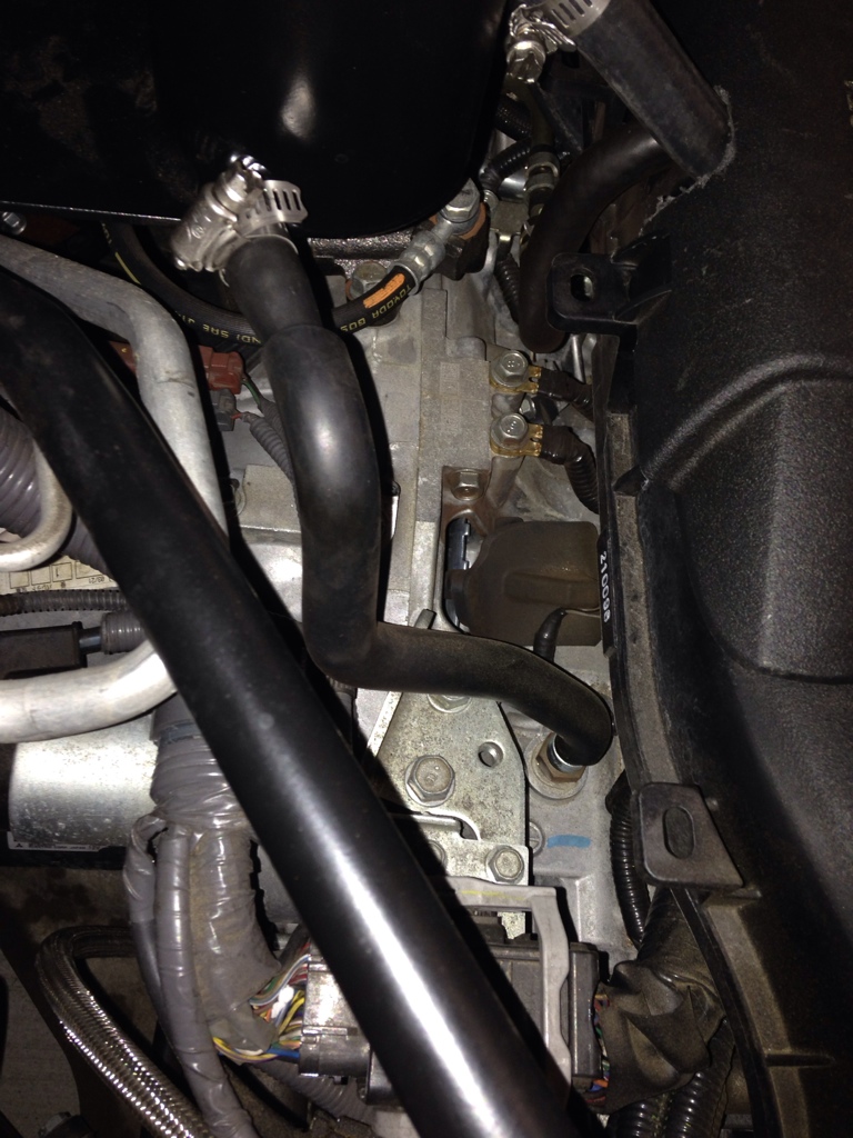

I was incorrect. I'm feeding to the start of the intake which is obviously better than what I thought.
That's the drain to the crankcase correct?
Other side has hose going down under A/C compressor. Is this where I should put the check valve or the hose in the first picture?
Thanks dudes.

Yes, that is the PCV and you need to install a check valve to prevent pressurizing crank.
