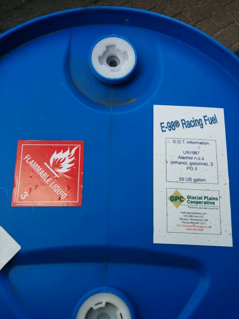

Old 07-16-2014, 01:02 PM   #13
Dipstik-sportech
Dipstik-sportech's Avatar
Posts: 1,813
Thanks: 842
The Following User Says Thank You to Dipstik-sportech For This Useful Post:
Pistol (07-17-2014)
Old 07-16-2014, 01:05 PM   #14
steve99
Drives: FT86
Location: Australia
Posts: 7,996
Thanks: 1,035
Thanked 4,994 Times in 2,984 Posts
Mentioned: 598 Post(s)
Originally Posted by Dipstik-sportech View Post
That would be almost drinkable with a little orange juice
waste on us NA guys about E60 is all we need
steve99 is offline   Reply With Quote
