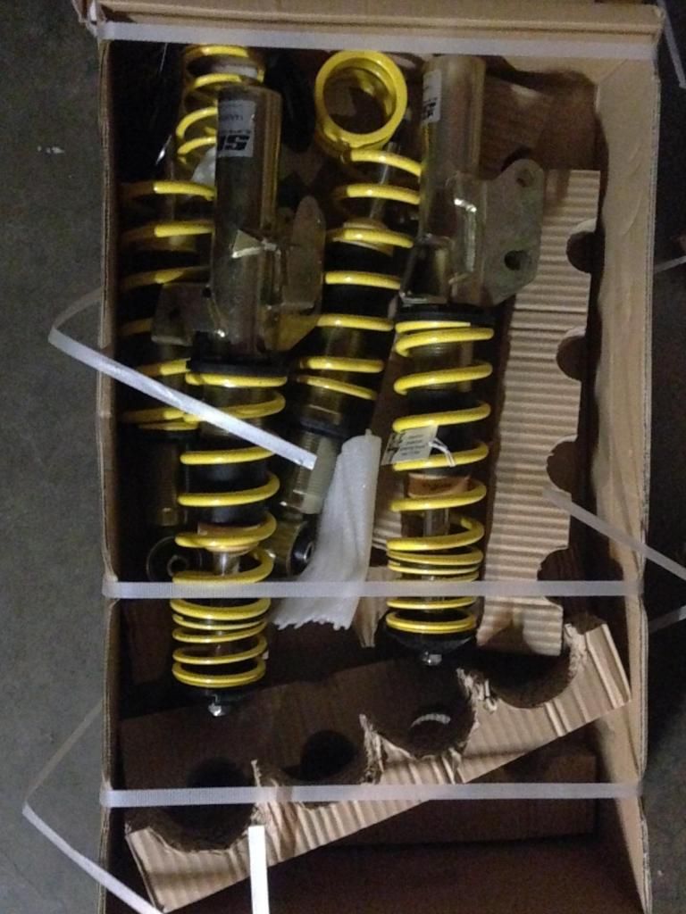

I just received my set and the when I opened it, I was shocked to see the condition it had arrived in. I didn't take any detailed pictures of the multiple chips, but didn't notice any dents or damage. Did anyone else receive them in similar conditions and complain to ST support about it?
Pretty much everybody who ordered a set, lol. I opted to just keep it with the paint chips and such; I doubt it will cause anything to fail prematurely.
