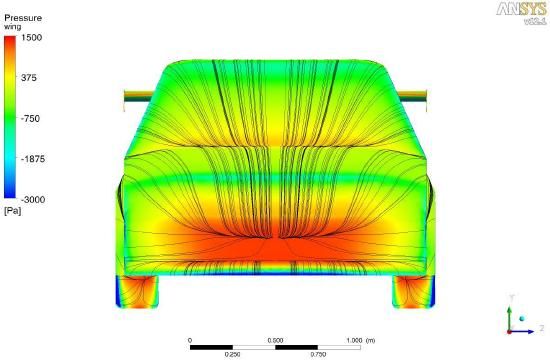

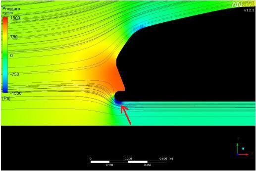

Meaning that the final design was the result of, say, a half-dozen or a dozen different iterations run through the software, resulting in this design being the best compromise in terms of downforce and, given the target market, practicality of installation, as well as pricing? If so, I wonder what results the designer got when he tested with a radiused leading edge (when viewed edge-on), and why that edge isn't a part of the present design. It would also be interesting to see the result produced by a rounded shape at the leading edge (when seen from above), as opposed to one that follows the design of the bumper cover.
These CFD-generated images using a generic street car shape give an idea of why a designer might choose a radiused leading edge:
