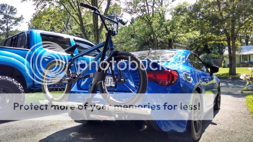

Was curious to see how this would with a thule sidearm roof rack, I used two stock factory tow hooks and welded a 1 1/8" bar to each since I don't have access to a lathe to get my mounting points. Got it all mounted up today, need to make a bracket/brace to hold it more stable, since I didn't mount it like its supposed to be on a roof (where the front wheel mount is actually mounted to the cross bar), if I did the bike would sit outside the passenger side of the car and a few feet in on the driver side. Its not a big deal, I trust it wont break or fall off or hit the car itself, just need to hold it more stable for my liking.

Do you think you would try 2 bikes? I wonder if that would be over taxing the mounts or hurt the car. It would be really nice to mount 2- 20lb mountain bikes back there for a road trip.

FWIW, I had a similar setup on my Boxster S. Except the rack was not bolted to the tow hook location. Instead, it was bolted to the bumperettes, which were aluminum and likely not nearly as strong as the tow hook location. I carried two bikes on there without issue.
That's certainly not a guarantee, but if I had to guess, I would say the OEM tow hooks could handle it just fine. As long as whatever you fab up is worthy, I say go for it.

2 mtn bikes in fork mount rails need to be spaced apart a bit because of the handlebars. With one bike there is not much moment arm but the 2nd bike hanging out there is going to add bit more load overhung. I took care to size the inserts close to the hole dia in the bumper to avoid a bending moment at the M16 threads. I would not do it unless I at least did a static load analysis on the solid turned inserts.
