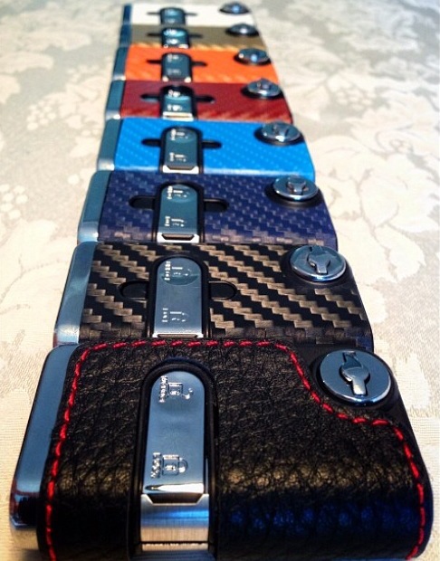

Size:  184.7 KBLast call. I have keys for
Sohail Sial
Aaron-Michael Rodriguez
Andrew Lischynski
Raymond Chau
Kevin Huynh
Am I missing anyone??? I want to get these shipped in the next couple days! Let me know by email only please. Arizona86club@ yahoo.com.

Attachment 84246Last call. I have keys for
Sohail Sial
Andrew Lischynski
Raymond Chau
Kevin Huynh
Sent from ARIZONA86 HQ
Do you make these yourself ?
Sent from somewhere
No, I'm collecting $ and keys and shipping them all together to have them made. $45 Name:  ImageUploadedByTapatalk1404711376.626256.jpg
@AZFRS86

No, I'm collecting $ and keys and shipping them all together to have them made. $45 Attachment 84247
I would gladly take one of these! I would be able to drop my spare off at Wednesday night at the weekly meet along with the cash
