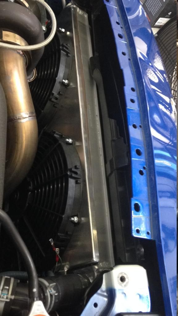

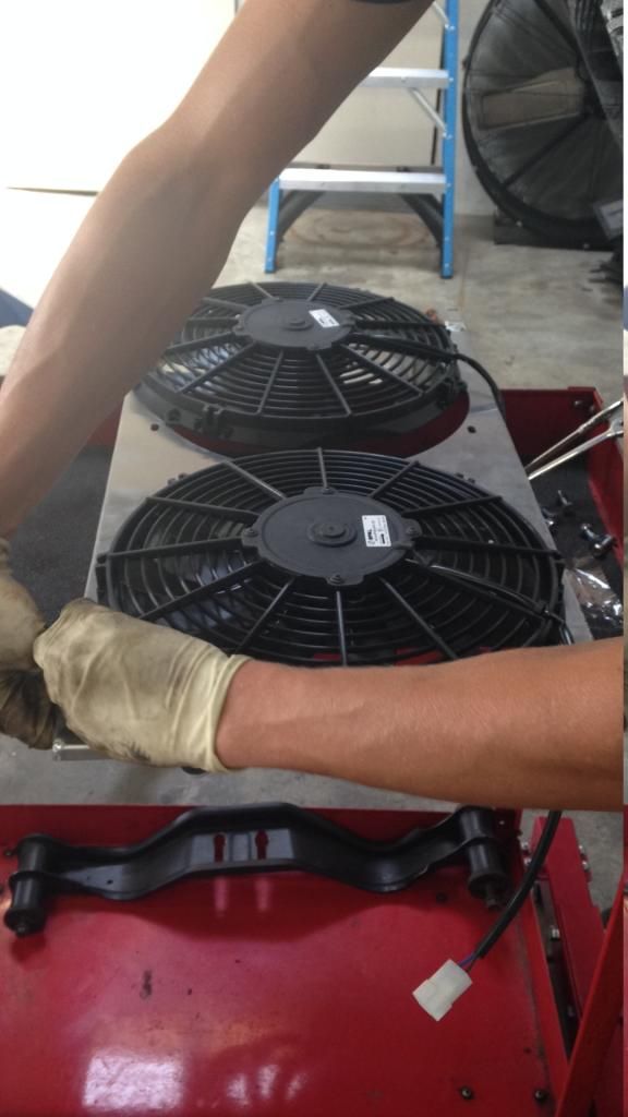

Thanks guys! love the new fans and shroud!!!!

Yeah just force it. Or unbolt your upper radiator mounts.
Nice fans, wish I had those. Mine melted.
