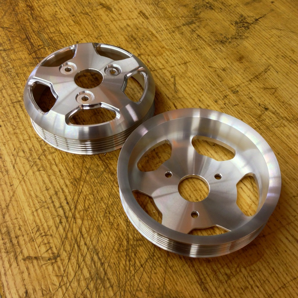

The redesigned water pump pulleys are coming off our CNC machines. Only 298 more to make and then off to anodizing!

So maybe 2 weeks? And u should do a comparison shot

Anodizing alone takes 2-3 weeks. Plus they all need to be post machined with the R logo and packaged. We are moving as efficiently as we possibly can.

I actually like the un-anodized version. The failure picture doesn't look like a problem with torque spec. since the breaks are at different locations on the spokes.

These are photos of the detached water pump pulley.

Looks slightly different specifically upside.

Interior and exterior faces were thickened. Mounting face was thickened, hence the reason for the counterbores and the width of the spokes were widened.

What does that do to it weight-wise?
