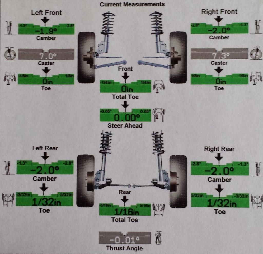

Just got back from my alignment/tire install.
Oh man these tires are amazing. Such a night and day difference front the stock primacy's. Going to give it a few days for me to fully feel the difference but I think all I needed was these tires and to finally get my alignment adjusted properly. I'll still probably get the sways in the future but I feel pretty good about where my suspension is setup atm.
Looks great!
- Andy

Originally Posted by Racecomp Engineering View Post
Looks great!
- Andy
Part of me wants more caster so I don't have to worry so much about static camber. MMMMMMM caster
7 degrees is pretty damn solid. Feels good man.
- Andy
- Andy
Chalk it up to the awesomeness that is @Raceseng cascam! I'll admit they are expensive but my god are they worth it!.
