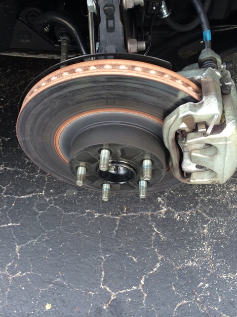

Does this look normal?

Hawk HP+ pads after a track day and auto x...
Thank you!!
Attachment 81620Attachment 81621
Attachment 81622
Thank you!!
PS: @CSG Mike I will get the carbotechs now!!
I have no idea WTF happened to the pads, but the rotors tell me that you're smearing the pad compound.
You definitely need higher grade pads.
Any of the race compounds will work, Carbotech included.
I think our Project Mu Club Racer special is ending this week, so you may want to try those if you want to hop on the deal. Otherwise, Carbotechs, Hawk DTCs, etc will all be okay.

That looks like the back of the outside pad, so that's probably just a collection of road gunk and dirt. The dirty spots were all exposed to outside air and debris, but it's clean where it was touching the caliper. I'd be a little concerned that the gunk looks very oily though. If it is, where did the oil come from?

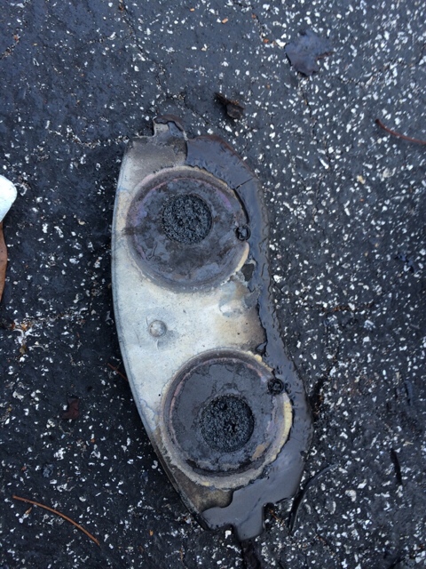

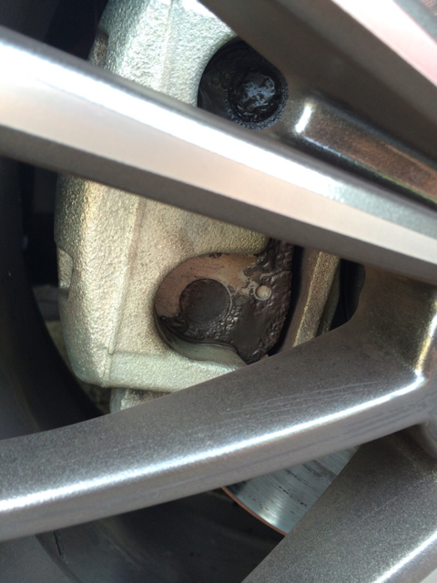

Got a track related question? I'll try to answer.
It's not oil, it looks like the back of the pads(front pads) caught fire or got really hot as the black covering on the back side melted off. Here is a closer look at the front side and back side of the front and rear pads. Are these pads done?
Hawk HP+
Front pads:
Hawk HP+
Rear Pads

looks like the paint/protective coating burned off. the white trd letters on my old pads bubbled up and looked oozy like that.

The thickness seems to indicate lottsa life left.
Hawk HP+
Front pads:
Hawk HP+
Rear Pads
Thank you!!
That happened to mine on the weekend I used them at NOLA. It was the protective paint coating that bubbled/boiled/burned off (i was actually watching it bubbling after I'd finish a 25-minute session). I plan on using them again because, like yours, mine appear to have quite a bit of life left to them and I never had any fading or issues on those days. Its just the back of the pad...
Thank you!!
It looks like the grease you used may have just burned off.
However, even with a lot of pad left, if they faded on you, you need to upgrade a few steps.
