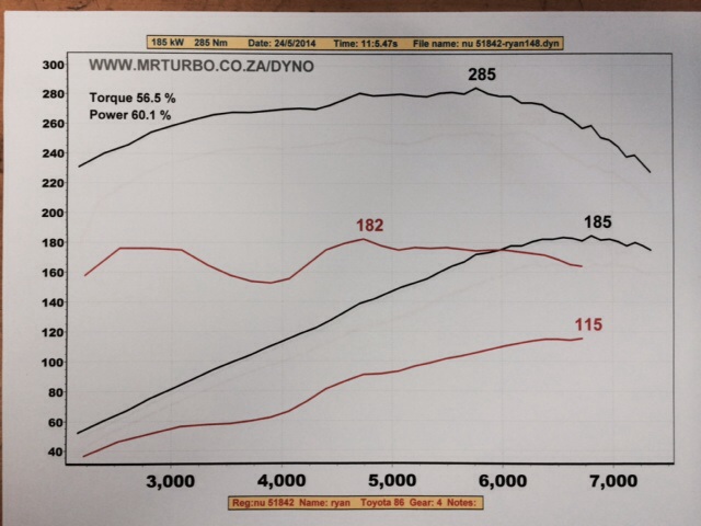

Though it would be interesting to see what gains we getting with this kit against stock. Test conducted on the same dyno.
My base was 115wkw = 154 whp on 95RON = 91OCT
Delicious tuned 5.88 = 185wkw = 248whp on 95 RON
70wkw gain = 94 whp gain
70mm pushing .8 bar boost.
HKS intake duct
AFE DIF
Borla header
Overpipe
Decat 63mm performance zorst

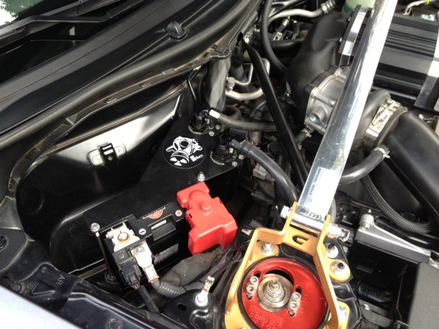

I get 20-30 ml in the crank case can every 5K, the other can collects minimal but it has added up over time.
I just finished my custom dual install with Shorai battery. Dropped 28 lbs over my previous install using the standard dual Radium bracket plus custom adapter and OEM battery.
