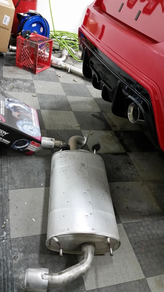

3" Nameless axle back (3" resonated midpipe on its way) and perrin intake.

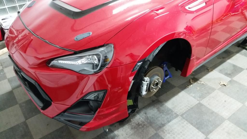

Now comes the not so fun part.

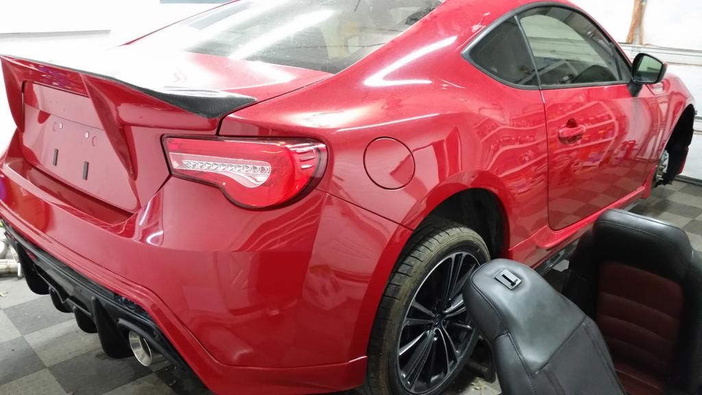

So the black portion of the OEM rear bumper is cut out and the toms is 3M/bolted on?

Yes - you have to physically cut the OEM diffuser with a knife. The toms is then 3M'ed on - but it doesnt really stick to the oem bumper. What we did was screw the bumper to the diffuser in from the rear and then glue it. then we removed the screws, and glued over them. Overall, this was one of the most difficult things of the build.
