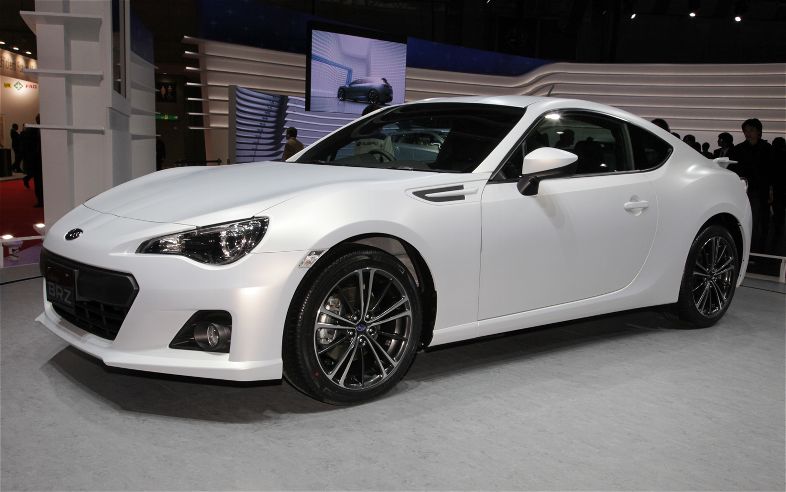

Hmm... I noticed FR-S owners posting in here exclusively.
Anyone with a BRZ actually remove the DRLs? Truth be told I never really looked at the fog light bezels that closely... my car is too far to check. hah
I was thinking of linking the boomerangs to the DRLs (as seen below), then deleting the DRLs
