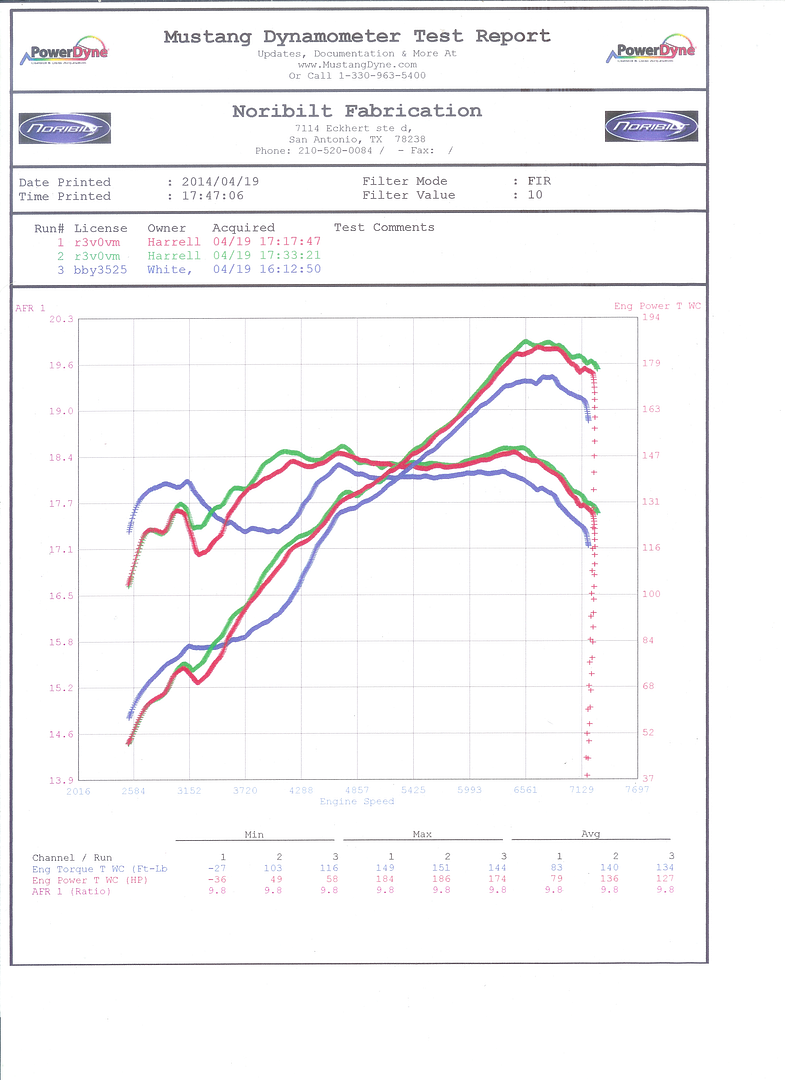

And the moment you've all been waiting for:
Blue - Stock BRZ that we dynoed before my car. So that we would have a base line number.
Red - My car which has the AFE Takeda intake, Nameless headers, Nameless Over/Front catted and resonated pipe, with the stock catback tuned on 93 octane.
Green - My car same as above with the only change being a Berk Technology muffler delete.
My car is tuned by Mike @ Moto-East

Originally Posted by FrsDuke View Post
Tuned?
My car is tuned, the red and green lines, blue is stock.

Originally Posted by DatApex View Post
Did you get one of your car before headers, and then your car after headers? I assume the green line is the same setup as the red, just with the track pipe?
No, I don't have a baseline for my car, which is why I brought the other car to dyno.
All of these runs were done today.
Do you feel the loss in low end torque the dyno shows ?
The HKS dyno's don't show as much loss but they don't have as big a bump after 3k. Interesting how different the two 4-2-1 headers are.
This is the HKS for those interested in the mystery's of FA20 headers:
http://www.ft86club.com/forums/showthread.php?t=41525
I know there are way to many variable to distill the difference between two headers into a dyno graph.
The key is still tuning and I would love to buy either header but I don't know anyone of mention who has dropped Ecutek for my and other's tatrix to tune with. Still a waiting game.

I can absolutely feel the difference with the stock muffler on. That's why I did the dyno with it. I wanted to prove it affected the cars performance with the headers.
Ah, so I assume you had headers on before hitting the dyno then. Darn. Curious to see gains from tuned, no headers to tuned, with headers, since that's going to be my situation.
Well he brought a stock car, at least enough info to show the loss in low end torque and the huge bump where the dip used to be. Should be a much smoother more traditional N/A engine ?
