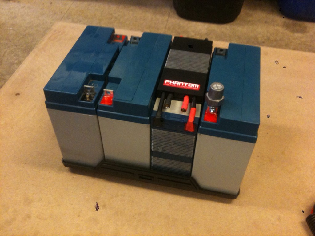

Originally Posted by robwbright View Post
Fenton, could you take pics of how you have the starter battery and ESC batteries installed under the hood? I'd appreciate it.
Now as soon as I get that check from the case I settled, I'll be ordering some stuff...
I have a picture. Name:  ImageUploadedByTapatalk1397410208.481041.jpg
Size:  139.7 KBName:  ImageUploadedByTapatalk1397410223.585071.jpg

Originally Posted by Sojhinn View Post
Thanks. Now I don't recall... is that the stock battery mount thingamajig or a replacement?
And what we're looking at there is 3 batteries for the ESC and a compact starter battery... correct?
Are you talking about the battery tray? If so I don't think so. My stock one looks way cheaper then that.
Rob will send it if you choose to purchase the conversion kit to dump pack 1.5.
The stock battery tray works for single dump.
Sent from my HTC One using Tapatalk
Think that will be my next mod

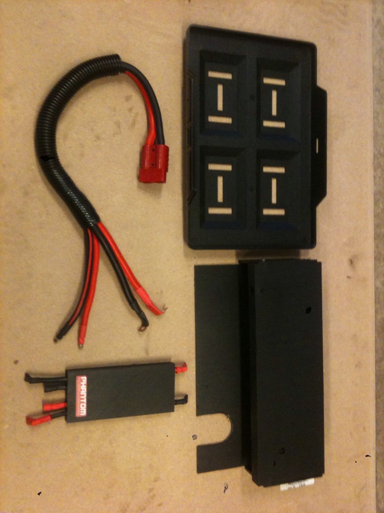

Installed! Although, I have a piece left over? Not sure if thats a good thing.
That is to connect the two dump packs together I believe.
Yes thats to get the dump batteries in series. Please be careful when connecting this.
