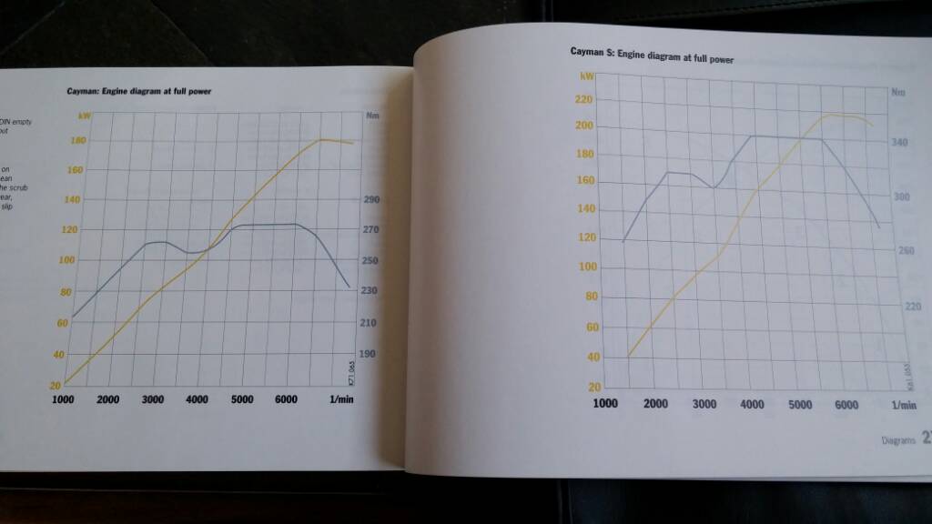

Here's some food for thought... It appears that our torque dip is common to NA boxer engines. It is just very apparent in the twins because the hp/tq is so low. Here is a shot out of my Cayman S owners manual. You can't feel the dip in the Porsche.

What I'm getting at is that it isn't just Subarus. It's the general nature of the boxer.

I agree that it can be easily eliminated. Just wanted to add to the knowledge base of the forum for those who assumed the dip was unique to Subaru motors.

Those Porsche charts are not DI for what its worth.
Attachment 73654
Consider the left graph. Look at the scales, the torque scale has the bottom 170Nm cut off, in other words, the torque fluctuation is amplified a lot. The actual torque dip here is 10Nm at most before it rises again. Or 4% of total torque. Nobody would notice that. On the S, it's relatively even smaller.
On the FRS, the torque dip is aorund to 40Nm. That's around a 20% reduction. Like someone lifts off the trottle for you...
