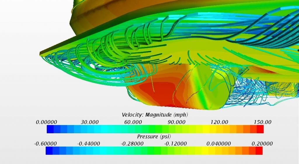

Originally Posted by plucas View Post
Sharp edges can create vortices. Vortices can be used to create downforce as shown below.
That vortex above created a lot of downforce across the splitter.
I'm confused. Are you suggesting that a thin splitter with no meaningful radius on its leading edge is the means to maximizing splitter-generated downforce? That is, slowing down the air passing across the bottom of the splitter by allowing it to separate from the splitter surface, or not attach in the first place, will lead to the splitter producing more downforce?

Ahhhhh splitters USUALLY decrease drag a little or are drag neutral when applied to a street car. This all depends on the design of course and how much downforce you want to create with it.
That is not what I am suggesting at all. A radius leading edge is good and provides benefits. You do not want to slow down the air under the splitter as that will create higher pressure. However, some separation can be a good thing in the term of creating vorticies. Vortices can be very powerful at creating downforce. The problem is controlling vorticies and getting them to go where you want them. I guess what I am getting at is the saying "there is more than one way to skin a cat". The problem I notice when online is a statement is made about some device aerodynamically and it is taken as the gospel in every situation.

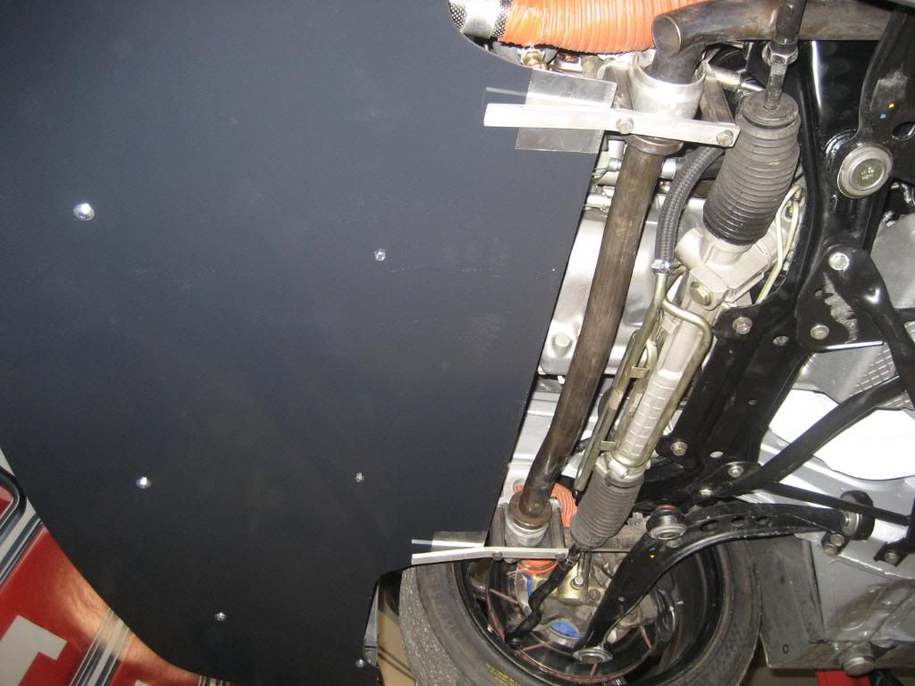

I can describe what was done on the M3:
1) The trailing edge of the splitter was well-supported (see the first photo below);
2) The bumper cover's OEM attachment points were retained, and are:
2a) Two tabs on the inside of the cover at the top trailing corners that were tied to the leading edges of the wheel wells with small sheet metal screws;
2b) Four bolts with 1" washers attached at the points in the photo in my first post where the turnbuckles are anchored through the cover and to the bumper beam; and,
3) Four screws ran from the bottom of the splitter and through the bottom of the bumper cover (these are the screws on the left in the first photo below) - IIRC, they screwed into something that held them fast that had been added to the inside of the bottom of the cover (I don't do my own work, so I'm a bit fuzzy on that part of the assembly).
This was for the first splitter we put on, and that's the one in the first photo below. It's 1/8" or 3/16" aluminum plate. The adjustable splitter came later, was added below the first splitter (a temporary arrangement during testing), and the turnbuckles were used to support it from above. The original aluminum splitter had no simlar support from above - it should have had, but it didn't.
The entire bumper cover/splitter assembly was removable in just a few minutes as the only screwed/bolted connections to the car were the screws and bolts listed in #2 above. Note that this implies that the brake ducts were not affixed to the bumper cover, which was the case; they were mounted in place in a fashion that allowed them to do their jobs without requiring any disassembly before removing the bumper cover/splitter assembly. This mounting arrangement can be seen in the second photo below.

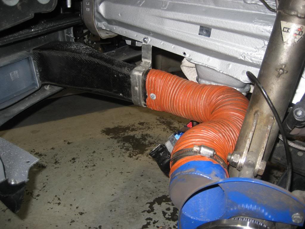

You can see here that the trailing edge of the splitter is supported by a pair of massive tabs held in place by stand-offs bolted to the swaybar mounts. That was another temporary arrangement. Of course, almost everyone here is going to be buying off-the-shelf units that will have undercar support solutions baked into them, so this kind of one-off fabrication won't be necessary.
Brake Duct Mounting sans Attachment to the Bumper Cover
