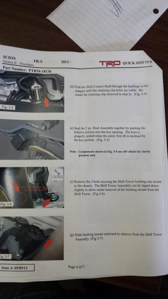

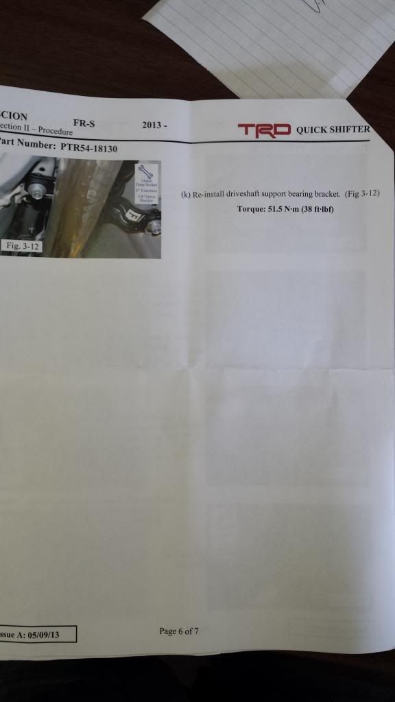

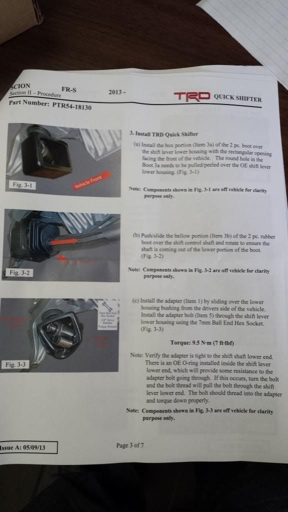

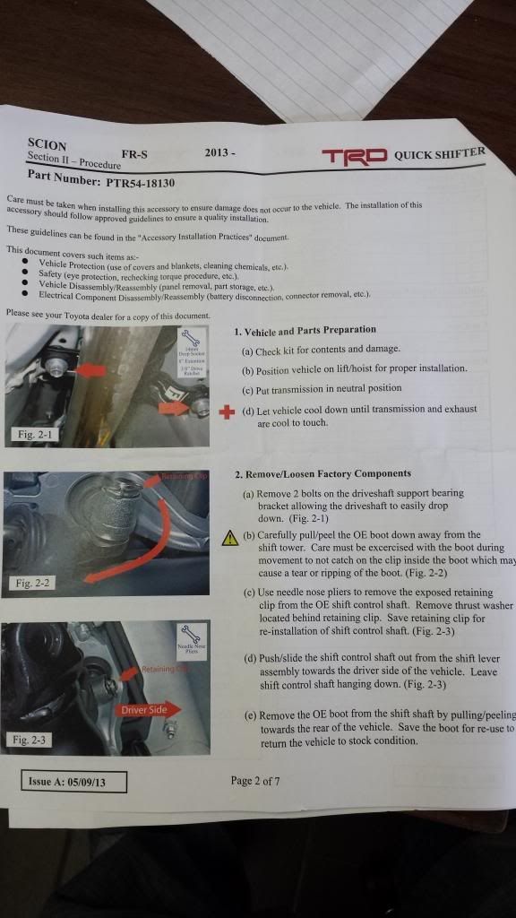

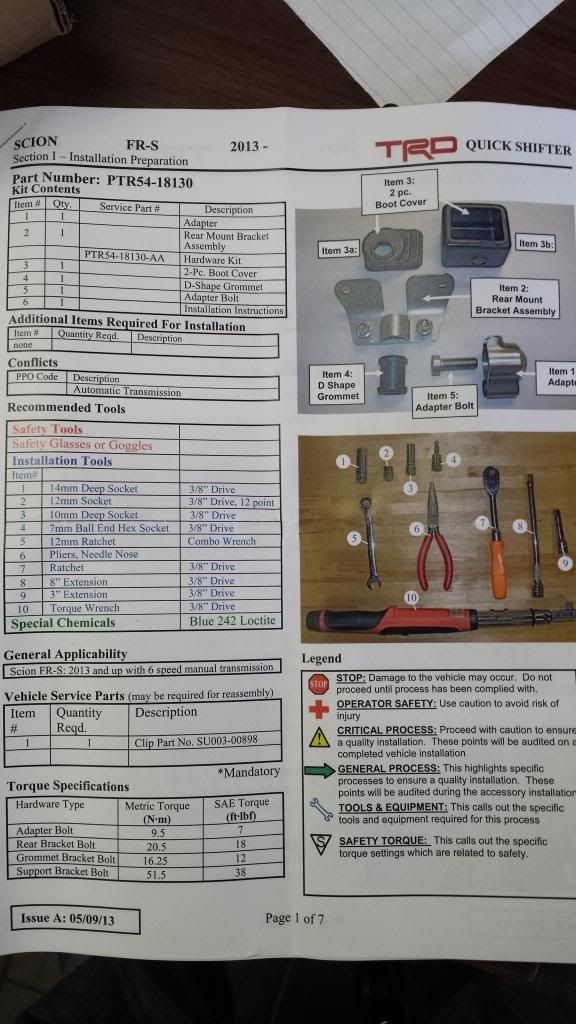

Can someone post the install guide or tell me what parts this replaces?

This shortens throws to what seems like the perfect throw. Is it possible to reduce knob height and still use this?
