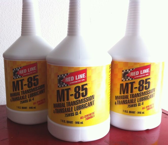

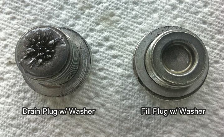

I just finished replacing my transmission fluid with Red Line Gl-4 MT-85. The job was a breeze... i took my time and it took no longer than an hour. The transmission fill/drain plugs do not have crush washers, they are solid and reusable. Noticed a small difference after test driving, but i'll know for sure after about a week of driving.
Anyway heres some pics:
The Fluid I used
Immediately after removal
After a quick wipe down

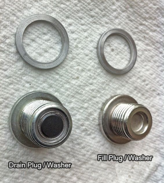

update part number SU003-03626 for the transmission drain and fill washer gasket is the same exact size as hondas transmission drain plug and it costs 2.27 instead of 11 bucks. save some money. hondas part number is 90471-px4-000
hope this helps guys
