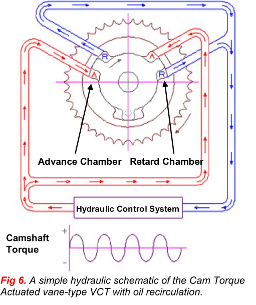

I know the AVCS is not totally on topic, but just for clarification before we move on:
These systems are called "cam torque" activated, but they still use oil as a control mechanism (see attached paper). As the cam hits the bucket (in Ford's implementation) or the roller finger follower (Subaru), the force makes the oil slosh inside the chambers. The spool valve is there to coordinate that sloshing in a controlled way.
In a conventional AVCS system, the oil is basically forced by hydraulic pressure to phase the cam. The source of energy is ultimately the oil pump. With this system, the oil is a way of transferring the force of the cam by sloshing in the desired direction at the right time.

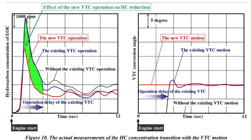

The intermediate locking position, which I didn't realize the FA20 was using, is a cold start emissions countermeasure, especially for meeting 2013 model year MSAT regulations of HC/NMOG at 20F/-7C testing. Aisin also uses that type of technology for Nissan applications. By dialing in overlap during cranking you get reburn of HC emissions that normally would have been thrown out the exhaust and unconverted.
The above image compares running no intake cam advace, versus hydraulically moving the cam at startup, versus having an intermediate lockpin with no delay.
