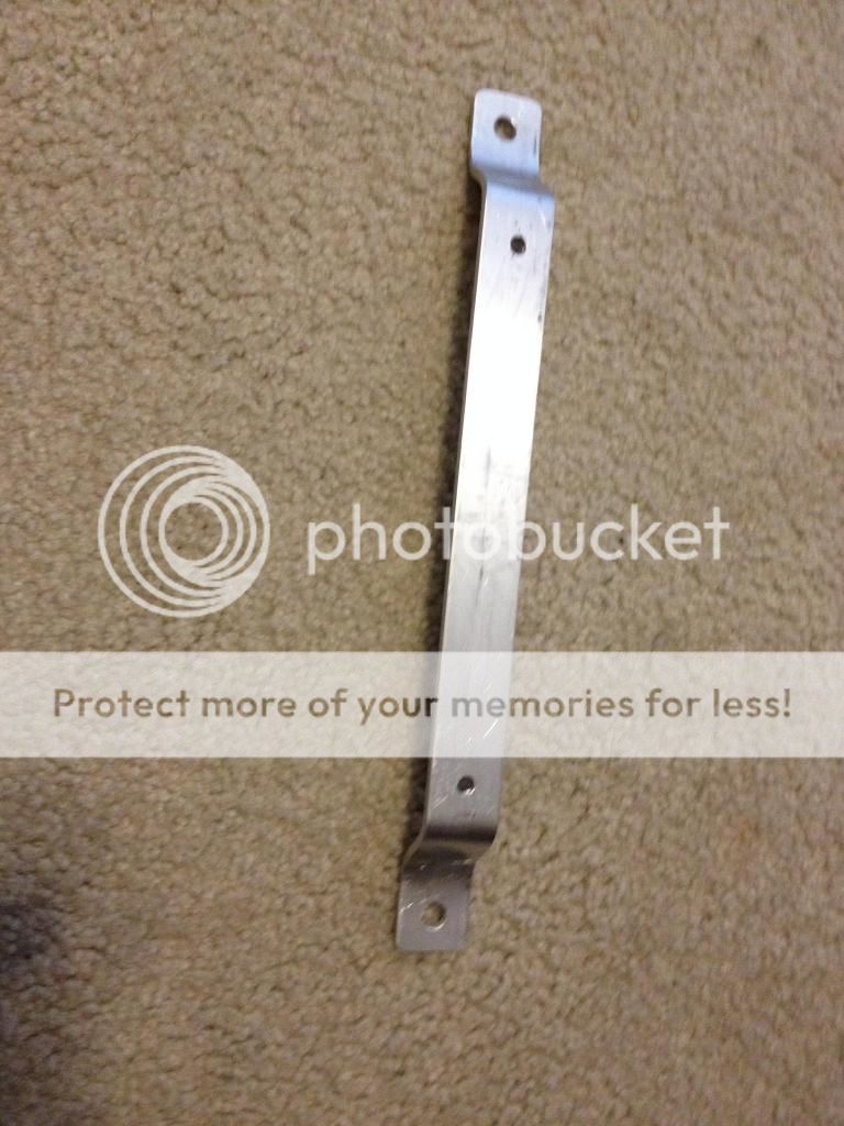

I didn't care for the OEM front license plate mount and I didn't want to pay $50-$80 for a relocation kit, so I made one for about $8.

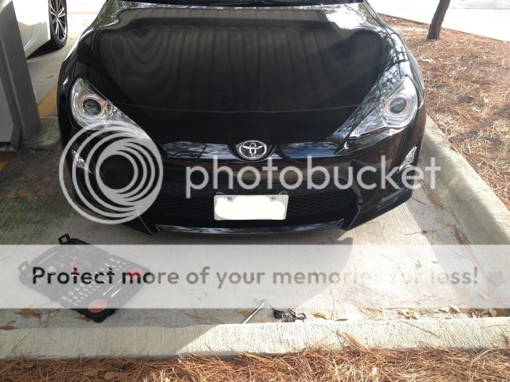

I had already installed the OEM kit, so I made this one so I could reuse the same holes that were screwed into the front grill.
Not much to it other than some bent aluminum, some tapped holes, and a little paint. See below for pretty much the whole process.

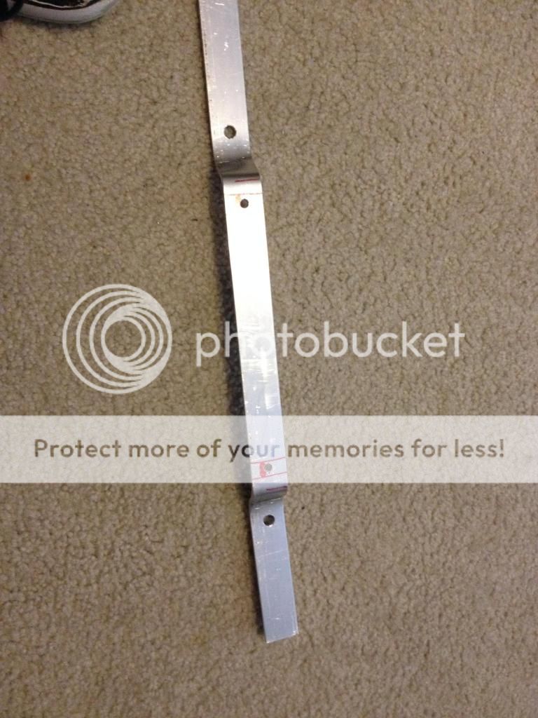

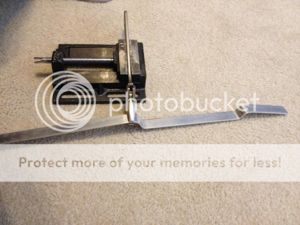

First, bend length that plate will secure to:

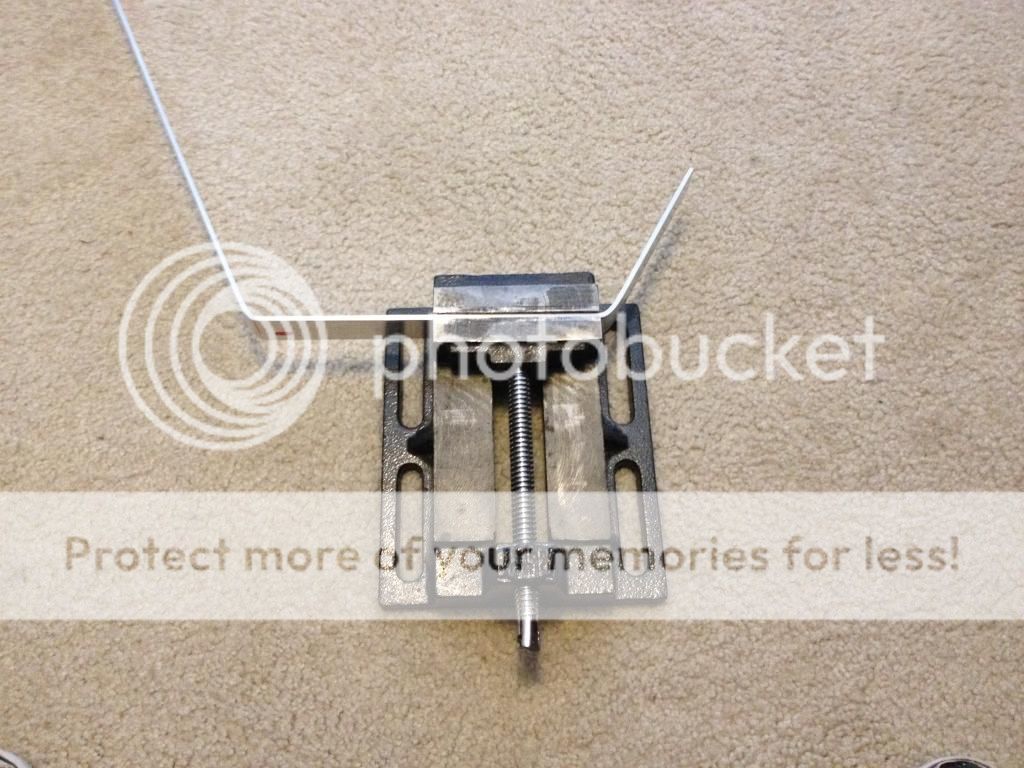

Couldn't get the bend I needed with my bench vice, so used an adjustable wrench to bend out the legs that will secure the mount to the car:
Drill clearance holes for attaching to body and drill/tap holes securing plate to mount (I used 1/4-20 screws):
Trim legs of mount and round corners:

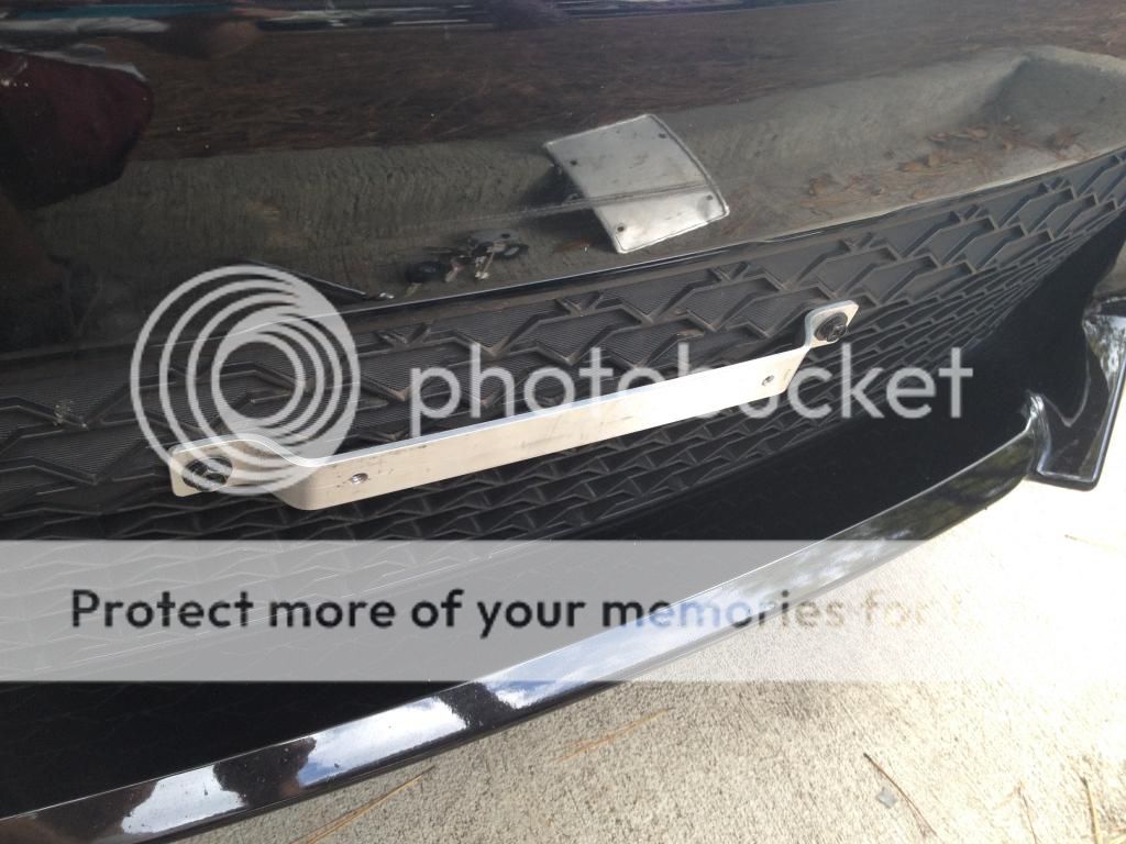

Mount to car:

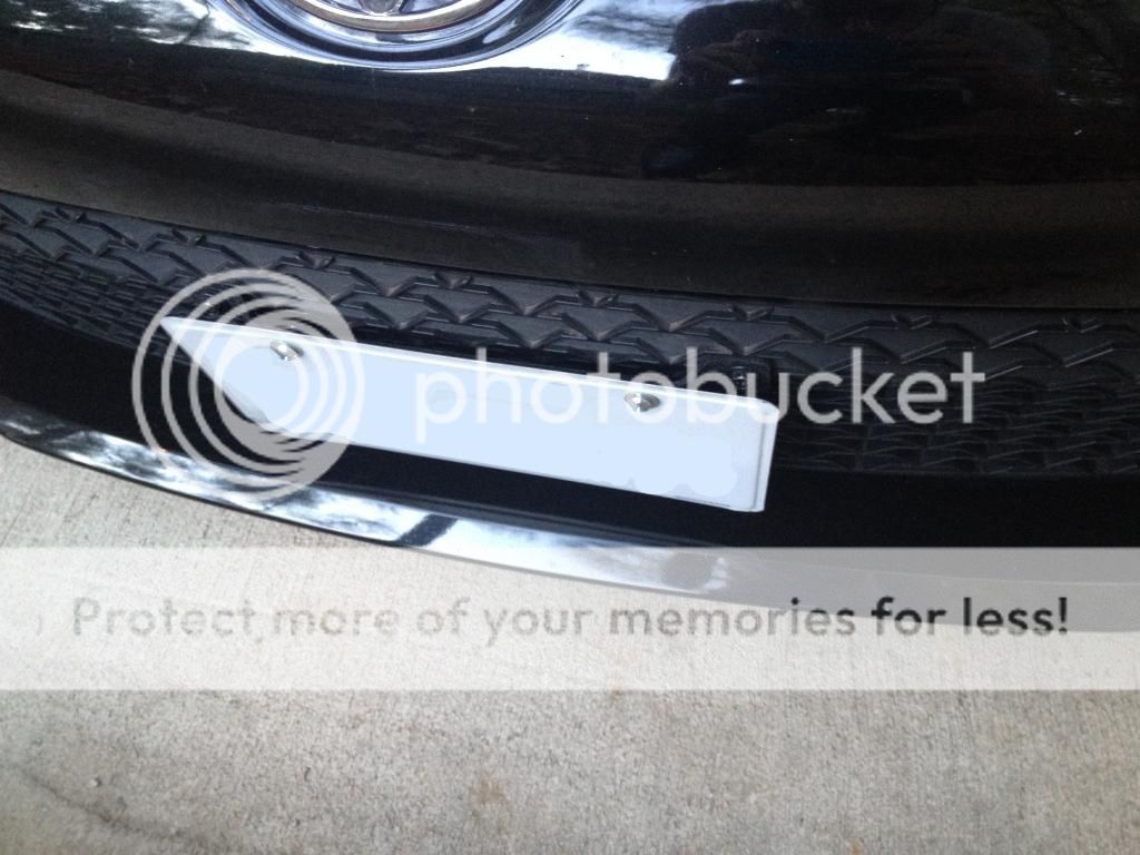

Here it is installed and painted, used some left over crinkle paint:

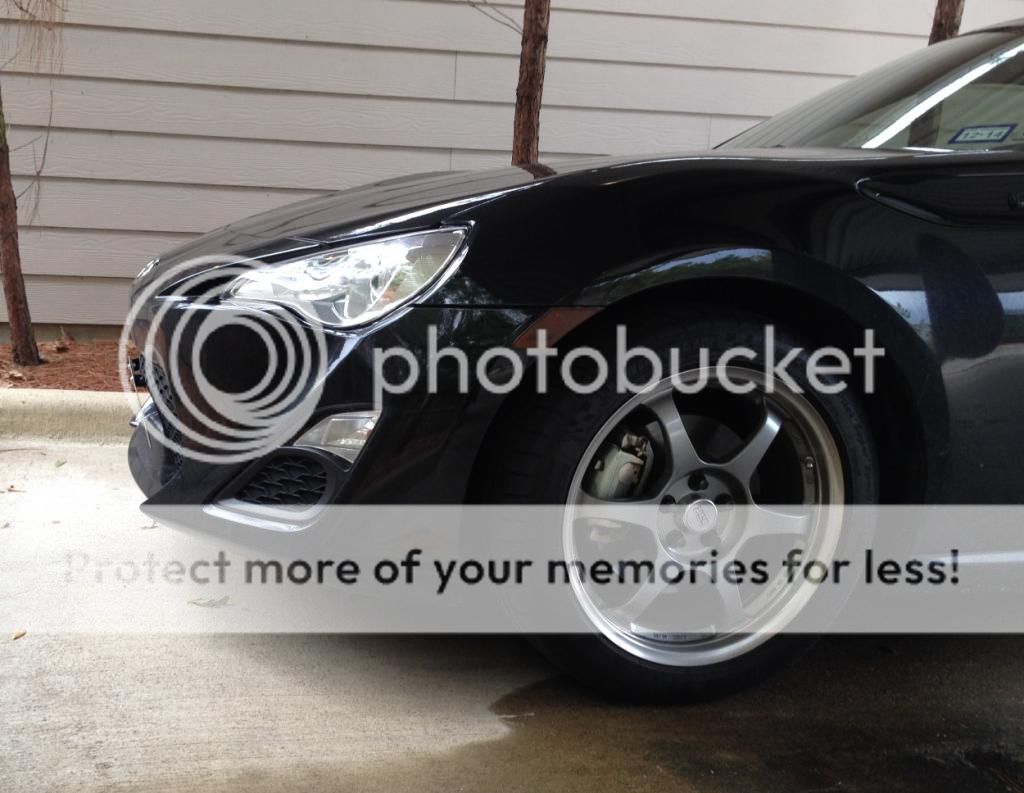

Do you have a picture like this but more from the side of the vehicle? I would like to see how the plate looks from the side.
Sure thing, hope these help. I don't think it looks weird, personally. It follows the angle of the grill for the most part. But everybody has different tastes.
