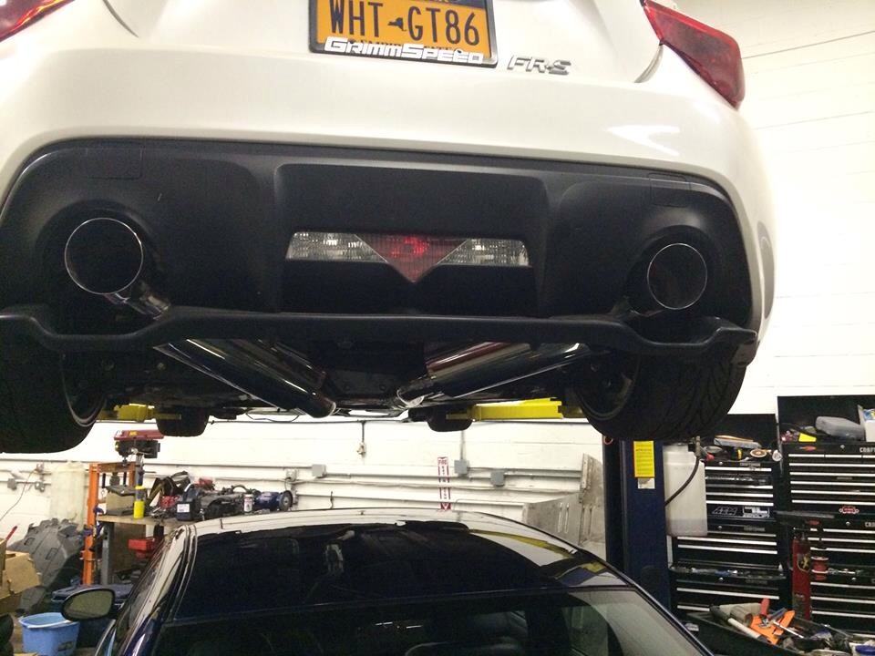

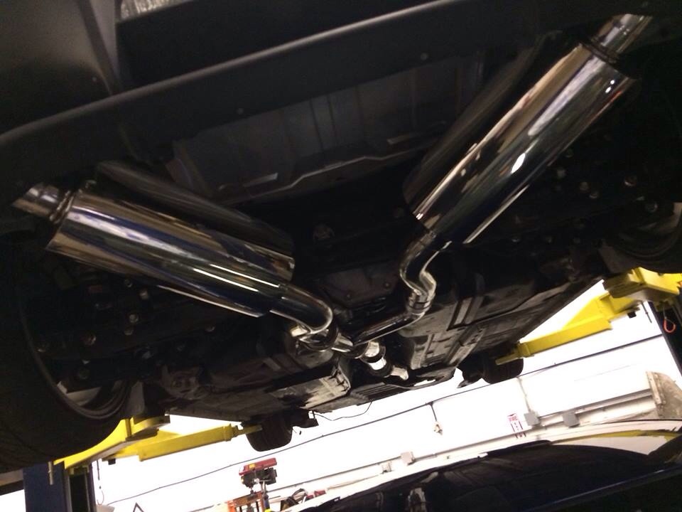

PTUNING FR-S/BRZ DS-330 SS 3" V-Band Header-Back Exhaust System
Size:  124.0 KBName:  ImageUploadedByTapatalk1392660700.074870.jpg
Here is mine
I havent seen it in person yet but to me it looks good
Only issue is that left can cannot be centered

cant rotate that vband?
from my understanding Nop
also i heard is MIG welded and no TIG welded

Mine is definitely centered.

You will need to loosen the v-band on the left muffler and rotate the piping on the flange to move the left muffler towards the left. PM sent with details on adjustment.

Exhaust sounds amazing
I will play with the vbands tomorrow
One thing i really hate is that exhaust sits really stupid low
