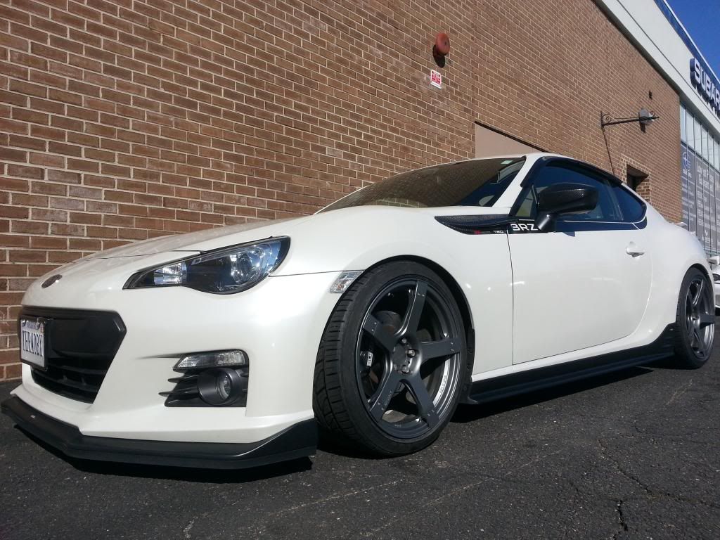

I posted here a few months back and still haven't found anybody with the specific setup of 255/35R18 tires on 9.5 +45 offset wheels. I am concerned about the front inner clearance with the liner by the firewall or any suspension arms (not the outer fender lip/sidemarker). I am lowered 1.4" on coilovers with -1.9 degrees of camber in front.
I understand tire model matters for clearance and believe Hankook Ventus V12 would be a safe bet.
Not really "Meaty" but it might help answer your question @switchlanez. I'm on a 255/35 18x9.5 +44 with pretty much the same drop/aligment specs. Tire is a Bridgestone RE970AS.
Nice you got them on, looking good man! So I guess you haven't experienced rub at full lock?

Nope. Perfect fitment in my opinion @switchlanez. They're hubcentric too. I LOVE them.

A better look at 18x9.5 with 255/35/18
Sent from my SCH-I605 using Tapatalk
