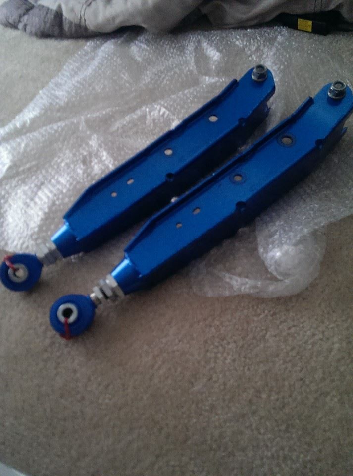

more jdm stuff. got me some cusco lower control arms from a member on here.
I had -2 degrees on my rear driver wheel and -3 on the passenger rear???? I got these to help correct my camber as much as possible so I stop eating through tires. I maxed these things out and still not where I want it. so I had to raise the vehicle up a little. I also ordered cusco toe arms that should be in Monday. pulling the camber back in shot my toe out the window, so I need to bring that back in. its an expensive game to be low...

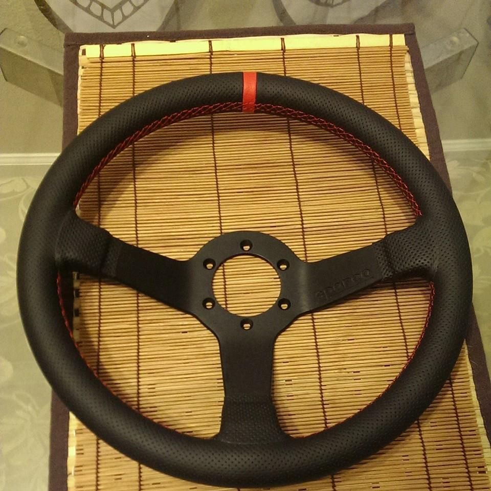

my wife got me a present, a little late for valentines day but it got here none the less

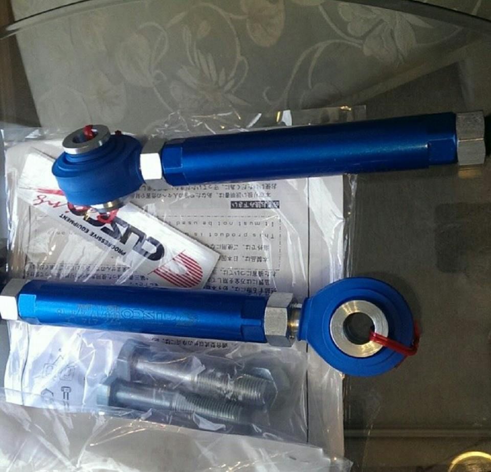

New JDM
cusco toe arms

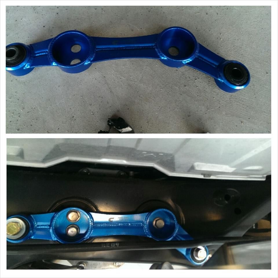

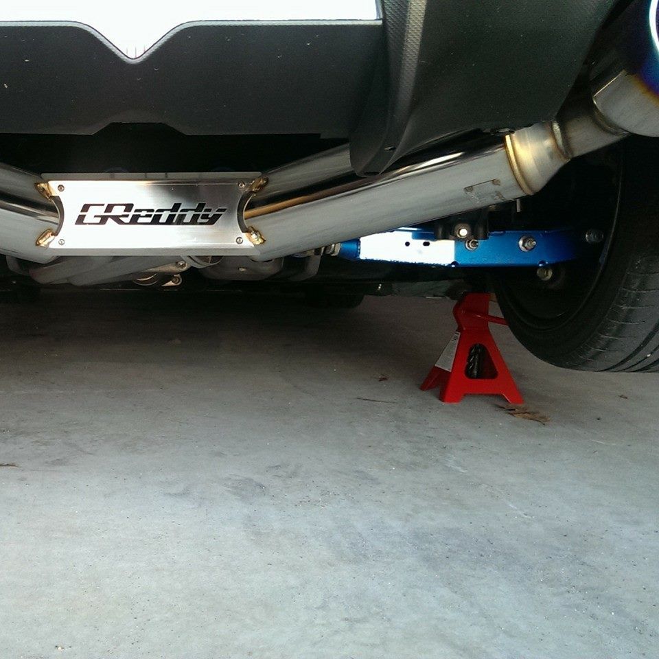

Got some more Cucos parts yesterday
rear differential brace. this thing is awesome. no more jump diff, so worth the money
cusco rear strut tower bar
and just a nice shot of underneath my car
